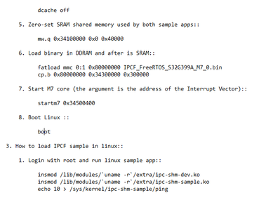

We are trying to build IPCF_FreeRTOS_S32G399A_M7_0 example in IPCF 4.9.0 using S32DS 3.5.3
We built the bin file and we copied it to the FAT partition of the SD card.
When we try to run the following logs

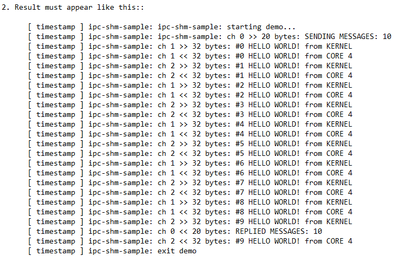

as per the above steps, the expected output should be like
but we are not getting anything.
We are using S32DS 3.5.3 , IPCF 4.9.0 and RTD 4.0.2 and Linux BSP 38.0.
Please let us know how to proceed.

chenyin_h
Hello, @Abhiram_m_s
Thanks for the reply and sorry for the delay
We have the following suggestion for your reference
  1. From the IPCF 4.9.0 release notes, the following packages are with dependencies:
  • RTD_4.4_4.0.2_D2306
  • FreeRTOS_10.4.6_4.0.2_D2306
  • NXP_RTOS_4_4_148_CODEDROP_0_4_0_D2309
  • NXP Linux BSP38.0
Seems the RTD version and BSP version are correct, how about the RTOS version used in your examples?
2. You may check the logs by dmesg | grep ipc-shm after executing the commands from your previous post.
3. The default IPCF version under BSP38.0 is IPCF v4.8.0(not IPCF4.9), so that when using the examples with the default settings, it is actually BSP38.0 (with IPCF v4.8.0) + IPCF v4.9.0, Which is causing problems. If you wish to use IPCF 4.9.0, you need to also update the BSP38.0 IPCF version to v4.9.0
