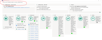

The first message received:
After clicking "Ok" configuration tool displayed error "Pins tool is disabled. Enable it or select a different tool":
I enabled it and opened.
But it shows the following error:
Appropriate to your recommendation I ignored it and clicked to "Update Code".
The list of the files for generation displayed with errors:
I clicked "Ok", but errors notification still displayed:
The Pins error is the same as I notified before - resource "platform.drivers.pins" is still absent.
I should add manually by clicking to

Daniel-Aguirre
Thanks for your feedback. It seems that there is a mistake under the steps being followed for using the Dio example. Since the Dio example is an AUTOSAR example, the usage of pin tools is disabled since it is not used by AUTOSAR.
When you enable the pins tool, it might be creating a problem since you are mixing AUTOSAR and non-AUTOSAR configurations. We can recommend looking into the below HOWTO's examples, in which some differences are shown differences between AUTOSAR and non-AUTOSAR projects:
If you want to use the Pins Tool, help us using the non-AUTOSAR example "Siul2_Dio_ToggleLed_S32G274A_M7".
Please, let us know.
