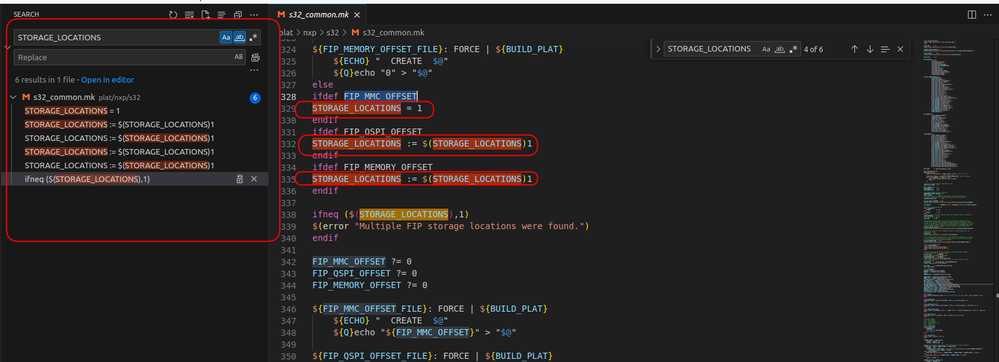

My NXP friends:
              In the ATF source code, I couldn't find any information about make FIP_ QSPI_ OFFSET, FIP_ MMC_ OFFSET, FIP_ MEMORY_ OFFSET, Can you tell me why? Thank you.
Screenshot from 2023-05-18 22-14-43.pngScreenshot from 2023-05-18 22-14-43.pngScreenshot from 2023-05-18 22-16-20.pngScreenshot from 2023-05-18 22-16-20.png

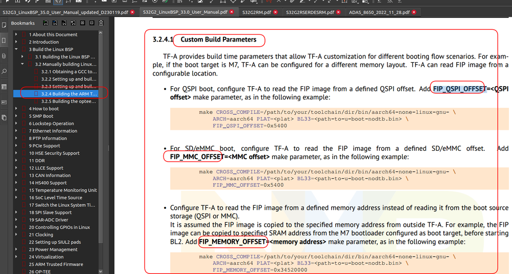

Daniel-Aguirre
Thanks for your feedback. As said in the BSP Reference Manual:
"For QSPI boot, configure TF-A to read the FIP image from a defined QSPI offset."
"For SD/eMMC boot, configure TF-A to read the FIP image from a defined SD/eMMC offset."
"Configure TF-A to read the FIP image from a defined memory address instead of reading it from the boot source storage (QSPI or MMC)."
These options should let you have control over where you want the ATF to be looking for the FIP image, depending on which interface you want to search over (QSPI, MMC or SRAM).

3,870 Views
Coco111
I have read the Linux BSP user manual and do not quite understand the functions of these three macros. Therefore, I looked at the specific code in the ATF source code, but I found that there is no corresponding C code to handle these three macros

Daniel-Aguirre

Coco111
Thank you for your reply. I understand
