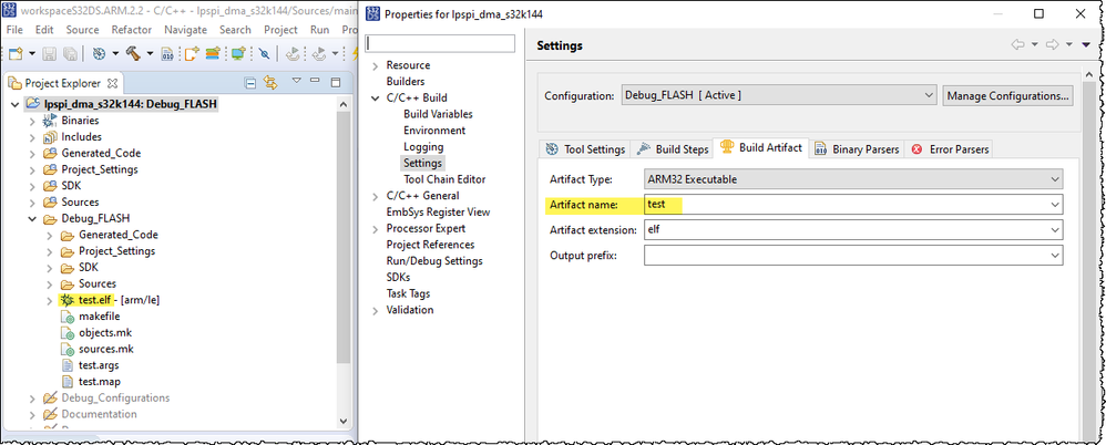

HI,
  In s32 SDK the build project creates a .elf, with projectname.elf as default.
But is there any way, without changing the projects name
I want to have the .elf name, of my choice ? I do not want to rename pressing F2, instead when I give build project it should generate the .hex/.ellf  with name of my choice. Is there a way to do this ?
Abhijith Shankar
1,791 Views
Robin_Shen
Hi Abhijith Shankar,
You can change the name of elf file in Build Artifact tab:
Robin
