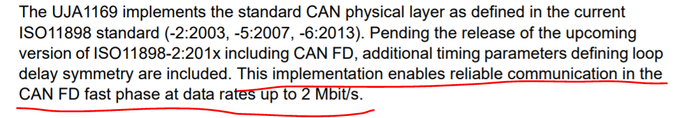

        I did a test on S32K142EVB. when the maximum data bit rate reaches 3.5M, my PCAN-USB Pro can still receive messages, but it is unsuccessful when it reaches 4MBit/s(data bit rate).
        And I found that this problem should be the cause of the UJA1169 chip.
UJA1169 Mini high-speed CAN system basis chip

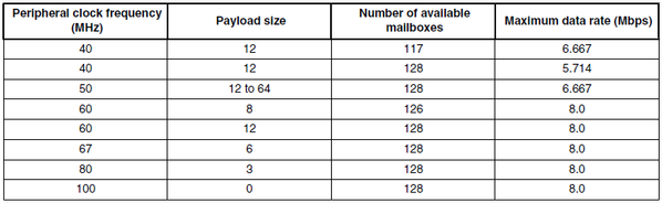

  And please refers to S32K RM: 55.5.10 Clock domains and restrictions
Table 55-34. Maximum CAN bit rate in data phase on CAN FD frames
 So, please check you CAN Phy,  user must ensure the bit time setting are in compliance with the CAN protocol standard.
