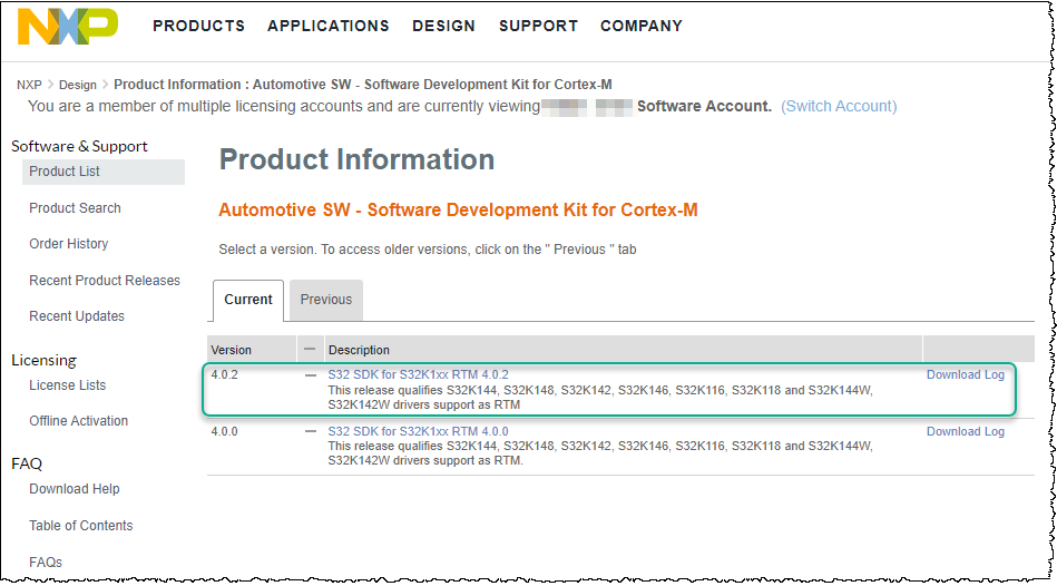

I have installed S32S IDE newly. My intent is to configure base driver code such PWM , ADC etc easily.
However while creating New Application Project , in processor list I do not see any processors and I want to add S32S in same. Refer Screenshot of same.
In Updates and extension also i do not see any updates.
Could you please help with what I am missing? And any other suggestions for S32S

You could have seen and installed the S32 SDK for S32K1xx RTM 4.0.2 in S32DS Extensions and Updates.
Please check Available S32DS Software Sites
If it still doesn't work, you can try to download S32 SDK for S32K1xx RTM 4.0.2 and refer to HOWTO: S32 Design Studio - Offline Install of Extensions and Updates
