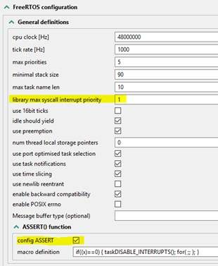

danielmartynek
Hi @issta,
The root cause seems to be in misconfigured interrupt priorities.
Test provided by the SDK team.

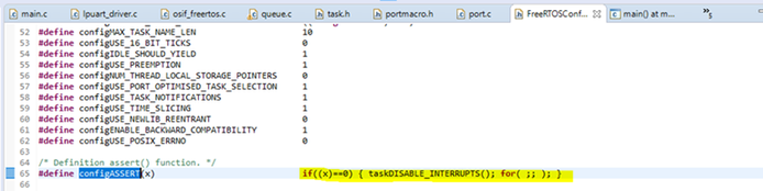

  1. Configure the maximum system call interrupt priority value is 1 and enable configASSERT() function to validate the interrupt priority.

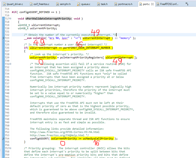

  • Inside the task, call the LPUART_DRV_SendDataBlocking() to transmit data, and the interrupt priority value of LPUART interrupt is zero (as the default value).
  • If the application in sun in the debug mode, we can see that at the end of transmission the OSIF_SemaPost() function is called to signal the synchronous completion object. This invoke to the funtion vPortValidateInterruptPriority() to check validity of the priority.
  • Currently executing interrupt have exception number 49, it belongs to LPUART1_IRQ and the numerical priority is 0 while the numerical priority of the system call is 16 (it equals to 1 << 4).
  • Because we do not call FreeRTOS API functions from any interrupt that has a higher priority level than the system call priority level (higher logical priority is lower numerical priority), so the current configured priorities lead to false condition inside configASSERT() function and infinite loop occur.danielmartynek_2-1650627001632.pngdanielmartynek_2-1650627001632.png
Conclusion
The user should configure interrupt priorities correctly, following:
  • When configASSERT() function is disabled, the validity checking of priorities will be removed.
  • The maximum system call interrupt priority value must not be set to 0.
  • When configASSERT() function is enabled, please make sure that the interrupts that call to FreeRTOS API must have priority level equal or lower than the system call interrupt priority level by calling INT_SYS_SetPriority() function to set priority value before running the task.(e.g call INT_SYS_SetPriority(LPUART1_RxTx_IRQn, 1), where “1” is the priority value).
  • For more detail about interrupt priority value that are used to FreeRTOS context, please refer to here: https://www.freertos.org/RTOS-Cortex-M3-M4.html

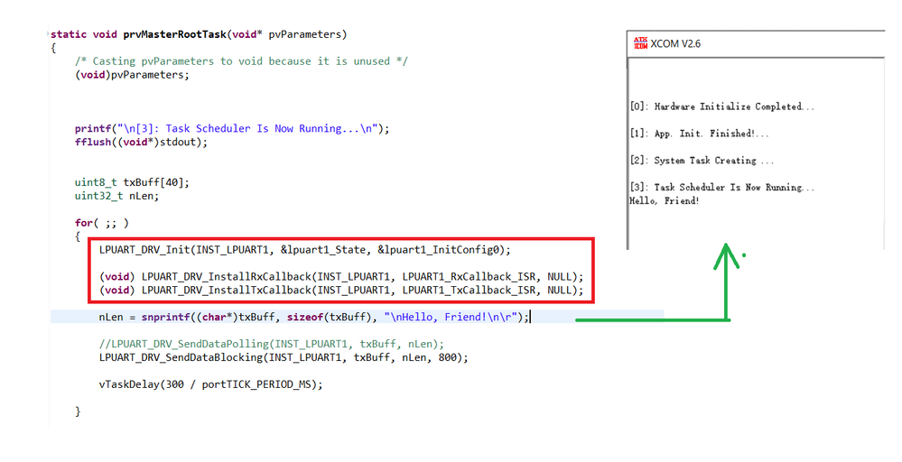

issta
hi, you means re-initialize the LPUART driver? I made the initialization of LPUART driver within the  function prvSetupHardware() by following code before  TaskStartScheduler():
/* Initialize PINS */
DrvInitRult += PINS_DRV_Init(NUM_OF_CONFIGURED_PINS, g_pin_mux_InitConfigArr);
/* Initialize LPUART */
LPUART_DRV_Init(INST_LPUART1, &lpuart1_State, &lpuart1_InitConfig0);
(void) LPUART_DRV_InstallRxCallback(INST_LPUART1, LPUART1_RxCallback_ISR, NULL);
(void) LPUART_DRV_InstallTxCallback(INST_LPUART1, LPUART1_TxCallback_ISR, NULL);
But I can make a test as you said!
