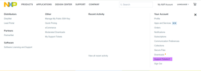

how to create the support ticket?
regards,
Hareesh
3,179 Views
VaneB
Hi @Hareesh
On our main website at My NXP Account.
