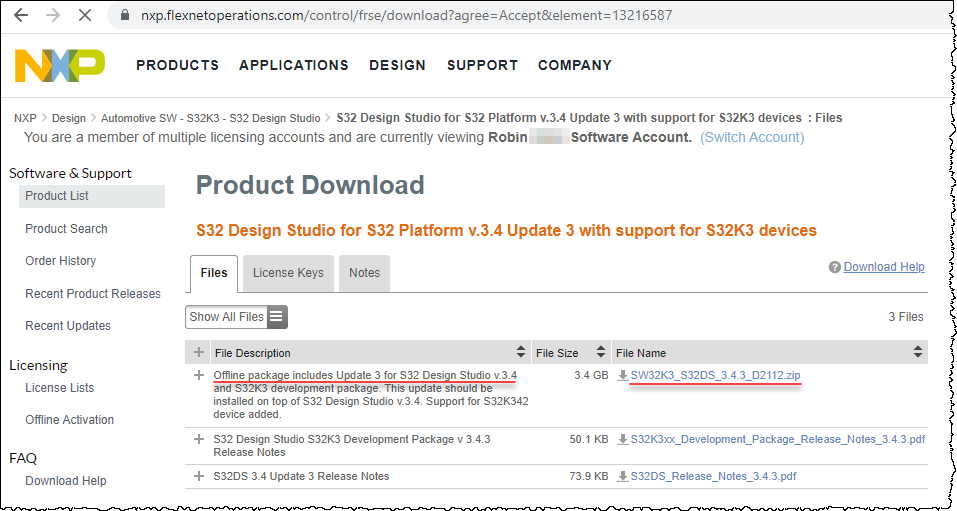

I am new to S32DS 3.4, was trying to install 'S32K1xx development package' from S32DS Extensions and Updates, but failed. The reported msg as the attached screenshot.

Please online update S32 Design Studio Platform package and S32 Design Studio Platform Tools package. Or offline install it:
