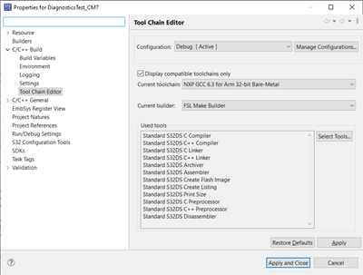

Here the part of the log file which shows that the linker tries incoroprating a nonexistent crt0.o object:
Building target: DiagnosticsTest_CM7.elf
Invoking: Standard S32DS C Linker
arm-none-eabi-gcc -o "DiagnosticsTest_CM7.elf" "@DiagnosticsTest_CM7.args"
c:/nxp/s32ds.3.5/s32ds/build_tools/gcc_v9.2/gcc-9.2-arm32-eabi/bin/../lib/gcc/arm-none-eabi/9.2.0/../../../../arm-none-eabi/bin/real-ld.exe: cannot find crt0.o: No such file or directory
c:/nxp/s32ds.3.5/s32ds/build_tools/gcc_v9.2/gcc-9.2-arm32-eabi/bin/../lib/gcc/arm-none-eabi/9.2.0/../../../../arm-none-eabi/bin/real-ld.exe: cannot find -lc
collect2.exe: error: ld returned 1 exit status
make: *** [makefile:76: DiagnosticsTest_CM7.elf] Error 1
"make -j12 TOOLCHAIN=linaro" terminated with exit code 2. Build might be incomplete.
Please guide me to the S32DS tool option which obviously needs to be adjusted.
BTW I also do not see where the option -lc gets set in the tool

After importing this project, and right clicking for "Properties", go into "C/C++ Build > Tool Chain Editor". The current toolchain for the project should show up.
Just to confirm, after downloading and importing the project, when going into properties, is the NXP GCC 9.2 toolchain selected?

Hi Julian,
Yes, this is a migration of an older project which I used for demonstrating certain functionalities to colleagues and customers. Hence, yes likely it was built with a different GCC at that time.
I tried the workaround described in the link which you sent. It made things even worse. It lead to 135 errors.
Well to my best knowledge I imported the project just as normal.
So how can I fix it?
BTW, I also wonder why a different GCC compiler lead to a failure message about crt0.o?
Existence and Absence of such file should matter of the project and not matter of the compiler version.
-Markus

Could you share some information from your project?
Are you building the diagnostic tests for S32G-VNP-EVBx Diagnostics? Also, I see on the path that gcc 9.2 is being used, but when importing the EVBx Diagnostics project on my side, I can build them correctly using the default gcc (6.3):
Finished building: ../src/s32g_test_all.c
Finished building target: DiagnosticsTest_CM7.elf
Invoking: Standard S32DS Create Flash Image
arm-none-eabi-objcopy -O binary DiagnosticsTest_CM7.elf  "DiagnosticsTest_CM7.bin"
Invoking: Standard S32DS Print Size
arm-none-eabi-size --format=berkeley DiagnosticsTest_CM7.elf
   text	   data	    bss	    dec	    hex	filename
 158264	 481664	 247728	 887656	  d8b68	DiagnosticsTest_CM7.elf
Finished building: DiagnosticsTest_CM7.siz
Finished building: DiagnosticsTest_CM7.bin
13:12:32 Build Finished. 0 errors, 151 warnings. (took 22s.434ms)
Did you port the example? Are you using another package? This issue may be caused by different GCC versions.
Also, take a look at this community post with a similar issue, it was resolved by copying some configuration from the GCC path: Facing Issue with Make file S32K144 [crt0.o : No such Directory] - NXP Community
