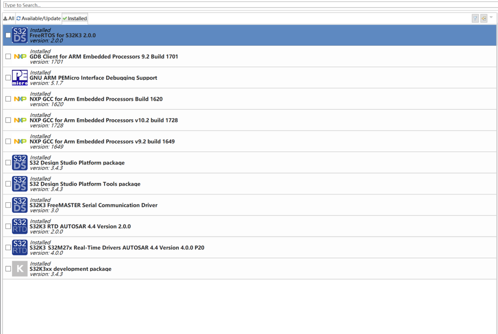

I encountered the same problem as this post.
https://community.nxp.com/t5/S32-Design-Studio/these-is-no-SCB-registers-in-peripheral-registers-vie...
The S32DS version I am using is 3.4. The installed extensions are as followsSnipaste_2024-05-13_16-33-58.png
2,062件の閲覧回数
VaneB
Hi @Janeting123
To view the information in the Peripheral Registry view is necessary to start a debug session. Could you check if you can see the information when debugging any example code?

Hi @Janeting123
I tested it with S32DS v3.4 and S32K3XX RTD v2.0.1 and there is no issue. Please instead of using the EmbSys Registers view use the Peripherals Registers view.
Additionally, the S32K3XX RTD v4.0.0 P20 was developed and tested with S32DS v3.5, so, its functionality is not guaranteed in older IDE versions.
B.R.
VaneB
