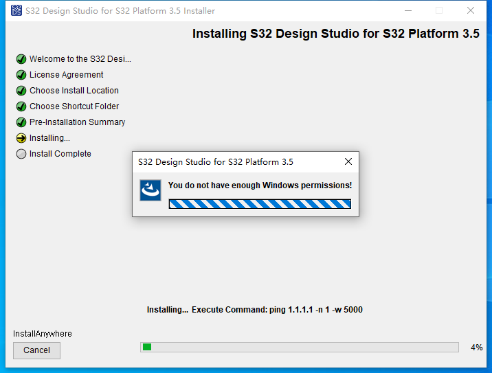

S32DS installation error

Hi @wergtw
it's necessary to run the installation as an administrator. This should solve the problem.
