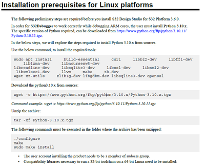

I'm trying to debug/program an S32G with S32DS 3.6 on Ubuntu 20.04. Everything builds fine, but I get this error when attempting to launch the debugger:
Could not determine GDB version using command: /usr/local/NXP/S32DS.3.6.0/S32DS/tools/gdb-arm/arm32-eabi/bin/arm-none-eabi-gdb-py --version; execution time 58 seconds
Could not find platform independent libraries <prefix>
Could not find platform dependent libraries <exec_prefix>
Consider setting $PYTHONHOME to <prefix>[:<exec_prefix>]
Python path configuration:
  PYTHONHOME = (not set)
  PYTHONPATH = (not set)
  program name = '/usr/local/bin/python'
  isolated = 0
  environment = 1
  user site = 1
  import site = 1
  sys._base_executable = '/usr/local/bin/python'
  sys.base_prefix = '/usr/local'
  sys.base_exec_prefix = '/usr/local'
  sys.platlibdir = 'lib'
  sys.executable = '/usr/local/bin/python'
  sys.prefix = '/usr/local'
  sys.exec_prefix = '/usr/local'
  sys.path = [
    '/usr/local/lib/python310.zip',
    '/usr/local/lib/python3.10',
    '/usr/local/lib/lib-dynload',
Python Exception <class 'ModuleNotFoundError'>: No module named 'encodings'
Python not initialized
This is in a fresh Ubuntu 20.04 VM running on an Ubuntu 22.04 host (because S32DS fails to install on Ubuntu 22 ).
Do I need to be hacking in an install of Python 3.10 here? Ubuntu 20.04 uses Python 3.8, but that's not what arm-none-eabi-gcc-py is looking for. The strace log attached along with looking at the binary with strings makes it look like Python 3.10 paths are hardcoded in.
Also seems odd that I'm getting that ModuleNotFoundError since
1) arm-none-eabi-gcc-py doesn't seem to be finding Python and
2) "import encodings" works fine in my system Python.

Hello @dustinr,
I have received the following information from the internal team:
Based on the attached log, it looks like a Python environment issue. Has the customer followed the instructions in S32DS.3.6.0/S32DS/help/pdf/S32DS_Installation_Guide.pdf chapter titled Installation prerequisites for Linux platforms to install Python 3.10.x?
For S32Debugger to work correctly while debugging ARM cores, the user must install Python 3.10.x. Please follow the relevant chapter to install the necessary tools. Once installed, open a new terminal, navigate to the directory containing the installed S32DS 3.6.0, and execute ./s32ds.sh to launch S32DS.
Please let me know if this information solves your problem.

That did the trick, thank you! I originally followed the S32DS 3.5 installation guide since I couldn't find the 3.6 guide on the NXP website, and it doesn't include anything about doing a non-distribution Python install. Has the 3.6 guide been published somewhere? I'm looking on this page: https://www.nxp.com/design/design-center/software/automotive-software-and-tools/s32-design-studio-id...
