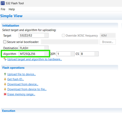

1.Which eval board are you referring to? - we are using s32se27x Eval board.
2. Are you using the same flash part number as the Eval board? - yes we are using S32 flash tool. Please check attached image . it shows exact error. Also we are using same IC and schematic of UART.
3.Are you using the same pins to communicate the flash memory with the S32E2 as the eval board? - yes , pin AC31 and AC32
If you design is not exactly the same as the Eval board, which are the differences? - In our board PMICS, clock, EPROM, UART , EATHERNET is same like Eval board, but there is no any RCON switches, Bootloader 1 and bootloader 1 pins directly connected to s32E pins . we can make change it high to low by changing jumper position on connectors.
4.When you mention "code is running successfully in Eval board." do you mean that you have run the same steps (erasing the flash via the S32FT) successfully with the Eval board successfully? - Yes, we have one code of bootloader working ok in Eval board.
5.Can you describe all the steps you are following to erase the flash from your board and from the Eval board?- first we checked board is working ok in debug mode. Then we connected USB to UART FT232RQ and load the code in s32FT tool. code is loading ok but it shows error Erase is fail.

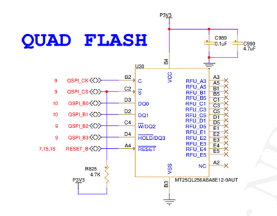

What I meant with the second questions was: Are you using the same QSPI Flash IC part number as the eval board? the eval bboard uses the following:
If you are using the same flash, you should change the algorithm in your flash tool as the following:
Please note that the QSPI number and CS may differ depending on your design.

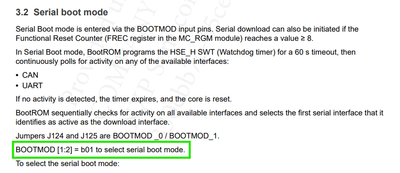

You mentioned that your board works correctly in debug mode, are you changing the BOOTMOD pins to boot in serial mode? you should use the following configuration [S32E27XEVBUG, Rev. 1 — 31 August 2023, page 4]:

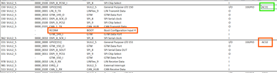

the pins in the S32E chip are [S32E2_IOMUX.xlsx, attached with the S32E2 reference manual, sheet S32E2_IOMUX, rows from 105 to 119]:
About the pins you mentioned (AC31 and AC32) I think there may be a little confusion, I checked the functionality of those pins and they are not QSPI related, I meant to which pins are you connecting your QSPI Flash memory and I don't see QSPI functionality in those pins, moreover, one is an RCON bit [S32E2_IOMUX.xlsx, attached with the S32E2 reference manual, sheet S32E2_IOMUX, rows from 1353 to 1363]::
