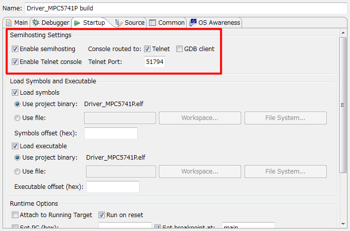

I'm now having a problem when using printf in the main function.
I do observe the messsage from the console.

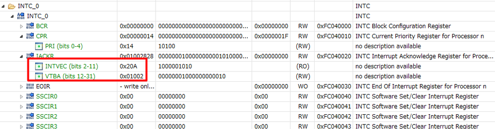

And the INTVEC is updated,but  the  interrupts can no longer be entered.
Without using the printf,  the interrupts work well.
I configured my project as the follows.
Is there any connection between the printf and the interrupts?
How can I use the printf  correctly without affecting the interrupts?
Best regards!

the only difference what I can identify is that you are using older version of PE Micro debug plugin. On third screenshot I can see gdbjtag.ppc_1.7.2 . On my machine is latest version - 1.8.3.
Try to update your PE Micro debug plugin - https://community.nxp.com/docs/DOC-342273
Hope it helps.
Jiri

Jiri is right, you have to update P&E plugin. They have fixed this issue since version 1.7.3

I updated the PE Micro debug plugin and now it works well.
Thanks very much.
