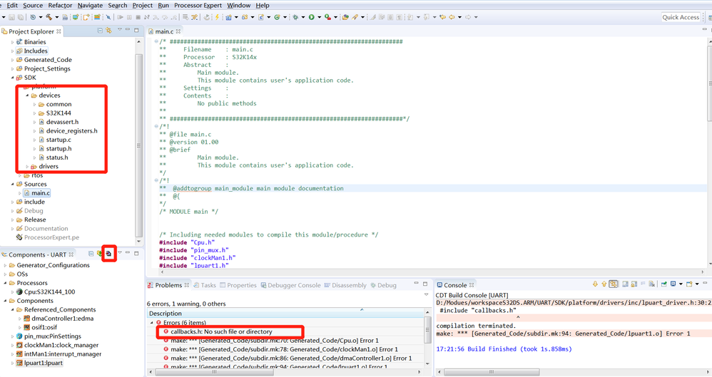

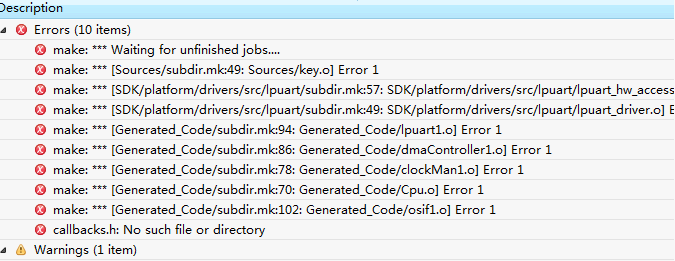

victor_song_171
I config the lpuart1 as serial port to communicate with PC terminal.The error like below:
problem description:
Any assistance with my thanks.

jiri_kral
did you generate processor expert code prior building main project? Normally is calbacks.h present in devices:
Jiri

victor_song_171
and if i build the debug one, the error disapear, but the RAM or FLASH one ,the error stand still.
4,294 Views

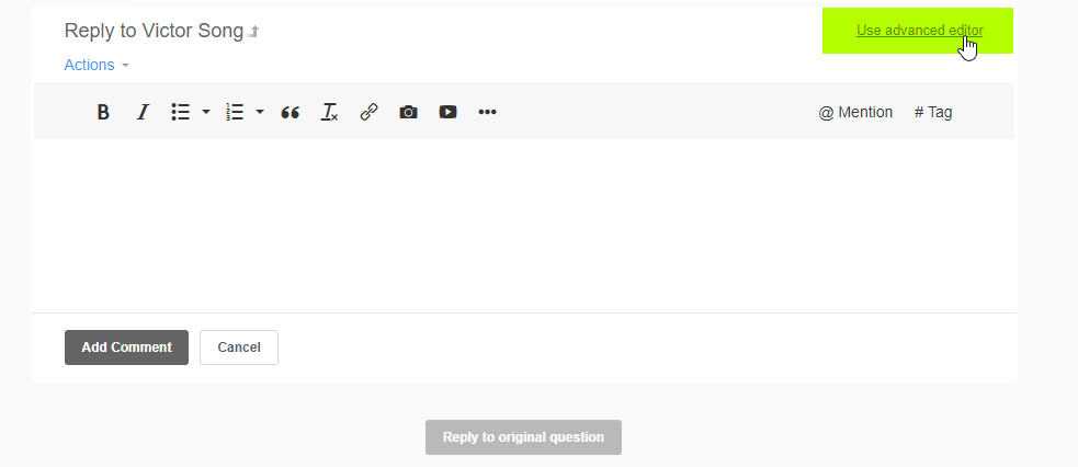

4,294 Views
jiri_kral
you can attach files in advanced editor mode:
Jiri

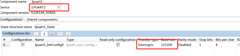

victor_song_171

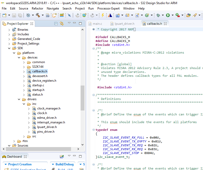

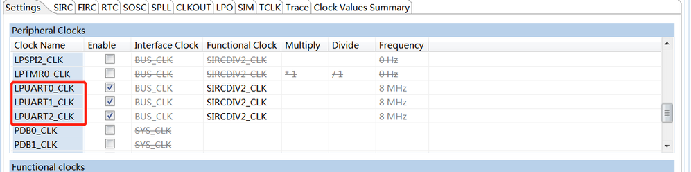

In S32DS, I config clockMan1:clock_manager, pin_mux:PinSettings ,add and config the lpuart1:lpuart,like below:
and then generate the code and build as FLASH ,the error apear.did i miss something to config?
4,294 Views

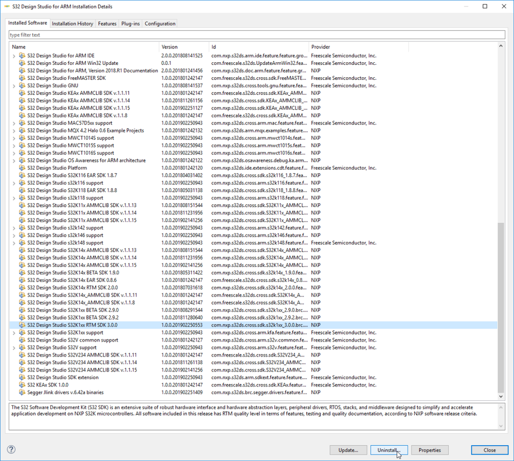

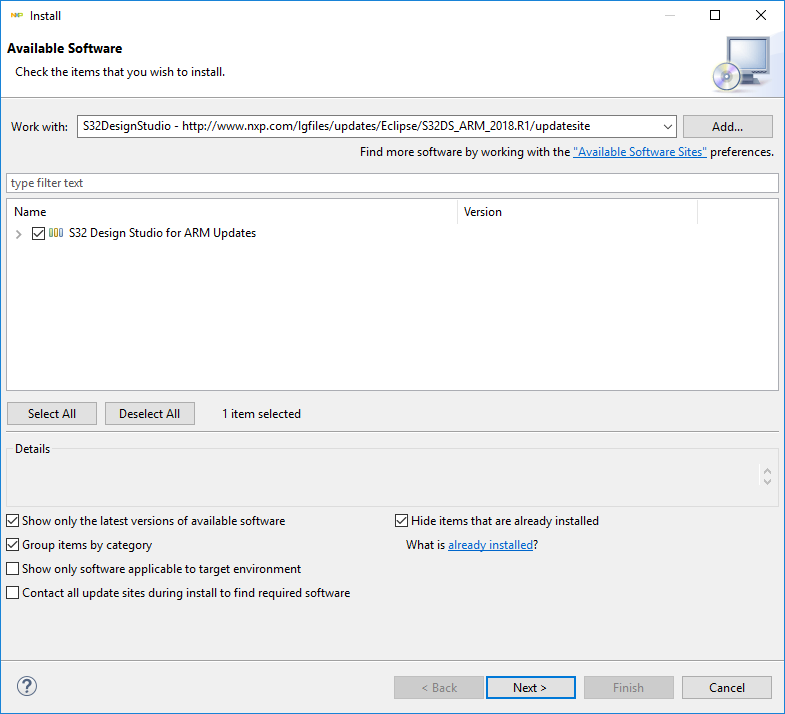

jiri_kral
you are doing it right. I went through the very same scenario: New S32DS application project, selected S32K144, selected SDK RTM 3.0.0, create project. Then I added LPUART component (requires osif and edma and confirmation of SDK version - SDK_S32K1xx_15 ), configured MUX pins and generate processor expert code. No issue for any of the available configurations (debug, debug RAM and release).
So, can you please check if the callbacks.h file is present on your hard drive? By default it is located in c:\NXP\S32DS_ARM_v2018.R1\S32DS\S32SDK_S32K1xx_RTM_3.0.0\platform\devices\ folder. If there is no such file - just uninstall SDK and install it again.
Help -> Installation Details and select SDK RTM 3.0.0:
When done, Help -> Install new Software and select S32DS update site:
Hope it helps.
Jiri
