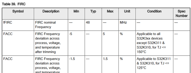

JayJay_H
Recently, I have been using STM0 as a millisecond level timestamp to start timing from power on
Prescaler is 240,clock source is FIRC_CLK(48Mhz)
The time is obtained through the Stm_Ip_GetCounterValue(0) interface
During use, it was found that the obtained time was faster than normal time, for example, the actual time passed 500ms but the obtained time was 600ms, and it has been getting faster all the time
But when I switch the clock source to AIPS_PLAT_CLK(60MHz) or FXOSC_CLK(16MHz), the time value obtained from the interface is accurate
The attached image shows my configuration of STM and Clock in DS. Do I have any other options to configure?

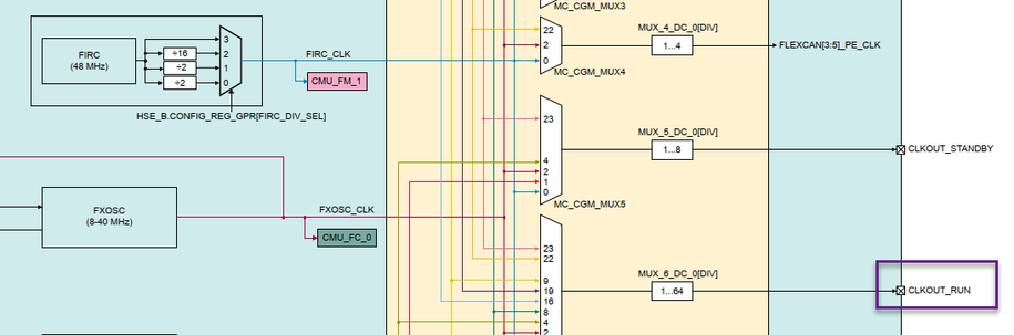

danielmartynek
Hi @JayJay_H,
I can't explain the 20% inaccuracy.
But +-5% can be expected.
FIRC can be measured at CLKOUT.
