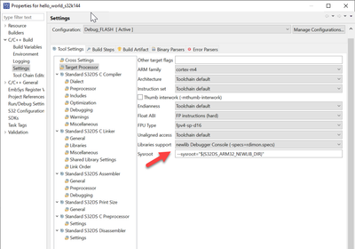

Where can I find the driver level source code for semihost printf support in SWD mode for the S32K?  Is it part of the newlib C library or is it a separate module?  I want to examine how the host mode works on the S32K to see how feasible it is to import into an existing project.

To enable the printf with the newlib library select the library with the debbuger console:
And in the debugger console enable the semihost option:

Thanks for the reply.  My question is where is the source code for this semi host and printf support through newlib?  I have a project which must not use newlib so I wish to gauge the feasibility of porting some of the code over just to support the semi host printf capability of the MCU.  I'm trying to find the internals of how this printf is working via newlib and semi host mode in other words.

Newlib is an open-source library, detailed information and the source code can be found on their webpage.
