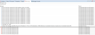

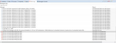

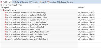

Strange behaviour of S32DS 2018R1. While working on project sometimes it is giving errors in code generation. Please refer the attached snapshot for details. When I create new project with same code and with same configuration, it works fine.

Thank you for providing the example projects. I looked at the two projects and found the following difference:
The project 'S32K148_EVAL_Demo_1' contains the 'Generated_Code' folder in the source folders on build path, but this is missing for the project 'S32K148_Eval_Demo'.
After I add the folder and rebuild, the errors are gone.

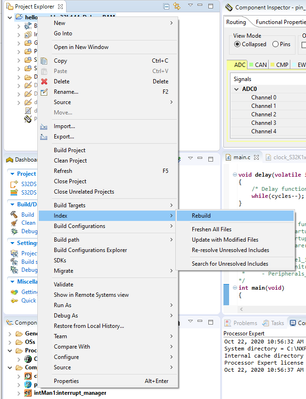

Hello @Learner ,
When you make the change to the indexer settings, probably it will trigger an automatic rebuild of the index. In case this did not happen, make sure to run the command 'Rebuild' within the Index menu as shown:
Without the rebuild, there would be no improvement.
Mike

I have already tried index rebuild option. But still errors are not removed.I am attaching the snapshot of error logs for reference.

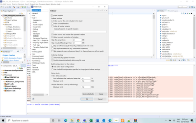

Learner
Still my errors are not resolve.I have attached the snapshot of index settings. I had tried to close and reopen S32KDS as well.
