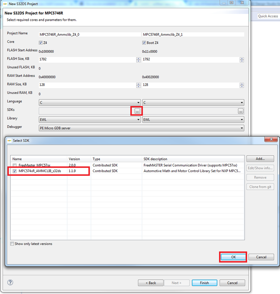

stanish
Hi James,
You are right. Thanks for sharing the solution!
BTW: if you are interested in the optimized production grade single precision math routines you can possibly use AMMCLIBs  (Automotive Math and Motor Control Library Set|NXP )
I'd recommend you to install the latest S32DS Power update which includes ammclib v1.1.9 libs plus new project wizard integration.
Hope it helps.
