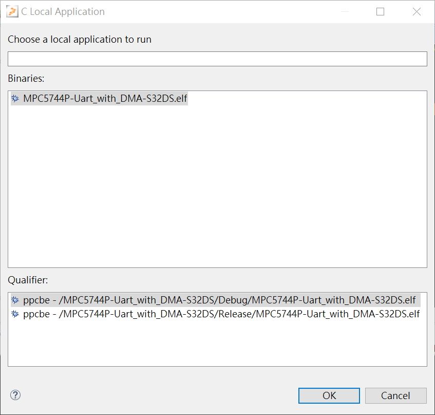

When I use "Run -> Run as" there are two options Local c/c++ application and S32DS c/c++ pplication.
I select one of them the another window shows C local application and then I select OK.
As show following figure:

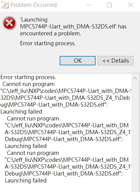

The new window shows "Launch MPC5744-Uart_with_DMA-S32DS.elf" has encountered a problem.
I don't know how to solve this problem. Does somebody give me a help?
Thank you very much.

martin_kovar
Hi Jeff,
functionality of this button is not implemented correct. Please use only Debug button to run your application.
Martin

jefferson_ll
Hi Martin Kovar,
According your instruction uses Debug button, I can run code in debug mode and Free run mode.
Thanks for your help.
Jeff
