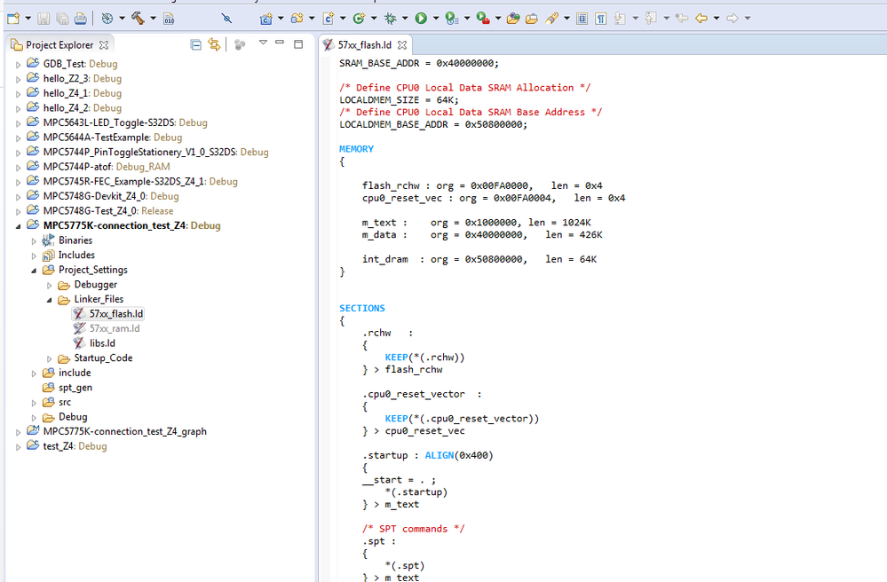

create new project for MPC5748G. Every project you create contains default linker file, which you can modify. Linker file is placed in folder Project_Settings/Linker_Files.
If you have any other questions, please feel free to write me back.
Martin

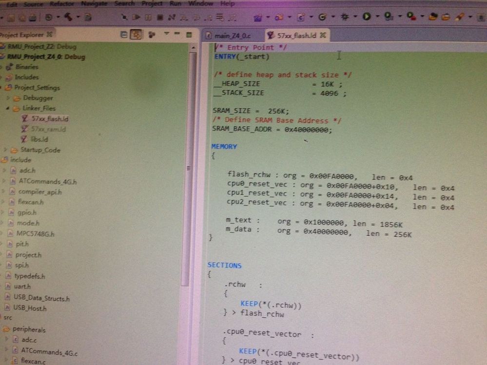

   Is 57xx_flash.ld  to generate MPC5748G flash.lcf?
    I used cpu0 ,but MEMORY have cpu0,1,2,

martin_kovar
57xx_flash.ld is linker file. There is no .lcf file in S32 Design Studio. Instead of it, suffix .ld is used.
When you create multi-core project, linker file for multi-core is generated and it does not matter, which core you are using now.
When you create single project only (uncheck the z7 cores buttons in project wizard during creating project), you will have following linker file in your project.
