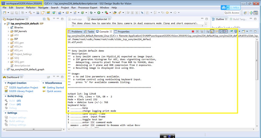

hello:
I use the board SBC_S32V234.
The BSP version I am using is VisionSDK_S32V2_RTM_1_3_0_img_yocto.
On the official website,the file name is as follows (yellow box):
S32DS_Vision_v2.0 is installed on windows7 64.
After I compiled isp_sonyimx224_sci_dcu:A53_Linux, the generated executable file was sent to the development board via SSH, and the execution failed, as shown below:
2,957 Views
liujinbao
After replacing S32DS_Vision_v2.0 with S32DS_Vision_2018.R1, the routine can be executed normally.
thanks!

jiri_kral
S32DS for Vision v2.0 contains VSDK RTM v1.0.0. Some examples aren't compatible with OS image from VSDK RTM v1.3.0. Please use OS image which comes with S32DS Installation.
Or you can use new S32DS - https://community.nxp.com/docs/DOC-342080
Jiri
