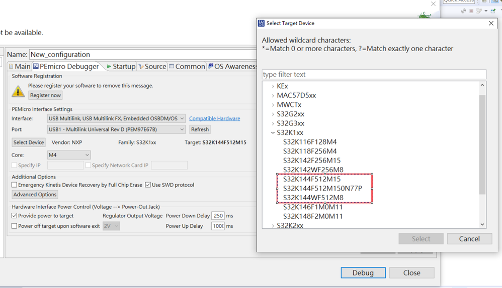

Hi ,
I created a new project for S32K144, and there are three Target Device for S32K144. The default setting is S32K144F512M15. I am wondering what is different between the three settings. I cannot seem to find any related document. The only one I found is part number on the page 9 of S32K-DS_Data Sheet, but the format is not specified as the name below.
Joe

Hi JOE,
The different between S32K144F512M15 and S32K144F512M150N77P can be found here:https://community.nxp.com/t5/S32K/What-difference-between-S32K-0N47T-and-0N77P/m-p/628450
S32K144WF512M8 should refer to S32K144W AEC-Q100 Grade 0 qualified (-40° C to +150° C Ta)
Robin

Hi Robin,
Thank you for the reply
I see the wording on my chip is FS32K144HFVLH0N57U, is it fine to use Device S32K144F512M15?
The LH should be V, M ,W for temperature rating according to datasheet
joe

You are correct. It's fine to use Device S32K144F512M15 on chip FS32K144HFVLH0N57U.
