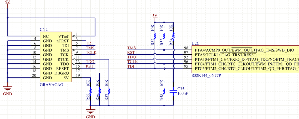

I developed hardware for version 0N77P, and now I received the 0N47T version and I am not able to burn/debugguer. Is there any hardware difference?

there's a lot of differences from software point of view (modules, interrupts, memory map...) but it's compatible in case of hardware. There's no difference in pinout (I means in supply voltages, GNDs...).
The only visible difference is: when the device is empty, 0N47T is periodically reset after power up. The device comes out of reset each about 120us and after very short time the reset is triggered again because because there's no valid reset vector.
There's Boot ROM on 0N77P which is executed after reset, so it's just hanging somewhere in software endless loop (that means reset is not triggered). Boot ROM has been removed on 0N47T.
Lukas

Can you check my hardware for connection to SEGGER Jlink, do you think the connection below is correct?
With this hardware I was able to write the 0N77P version perfectly. But all the MCUs 0N77P version already had a pre-loaded firmware (because they are from Eval Boards).
Thanks.

sorry for delay...
Comparing to this description SEGGER - The Embedded Experts - Interface description
... I can see nothing wrong.
Have you tried to check the signals by oscilloscope to see if there's something unusual?
Lukas

After unsuccessful attempts to burn via Jtag, I tried the burning via SWD, and thus succeeded. I do not know what may be happening, I contacted the NXP team here in Brazil and they also can not tell me what's happening, but they'll send me new samples and an EVB with zero-force socket to test the MCUs.
