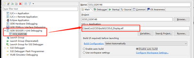

大家好,
     今天在配置debug的时候遇到如下问题。麻烦大家帮忙提供一个解决思路。
谢谢!
   相关信息:
           IDE:S32 Design Studio for S32 Platform v3.4
           芯片:S32K146
    操作:
2,219 Views
jiri_kral
please try to use
${S32DS_ARM32_TOOLCHAIN_DIR}/bin/${arm32_cross_prefix}gdb${arm32_cross_suffix}
in GDB Client - Executable setup. It looks that system is not able find gdb client.
