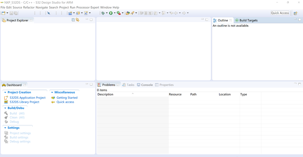

Hello:
    After installation ,The S32 Design Studio for ARM 2018.R1 startup interface is abnormal .Compared with the software interface in the user manual,The interface menu bar and toolbar of the newly installed software are missing many items.The menu bar, for example, doesn't have ConfigTools.And the toolbar is missing more items.As shown in the picture below.Is this normal?

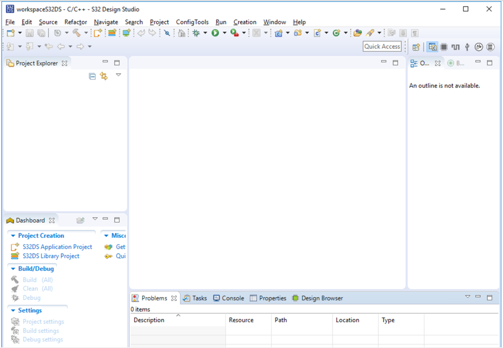

The next picture is from the user's manual.

Hello liuqimin‌,
If you had previous version of S32DS installed using the same workspace, we recommend that you create a new workspace for S32DS for ARM 2018.R1. The version of eclipse is different and some incompatibilities could produce some strange issues. This could be the reason. Please try to restart S32DS and select a NEW workspace.
Hope it helps,
Mike
