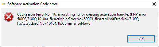

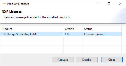

francesco_matti
Hi mikedoidge‌,
Could you please describe the issue in more detail? yes
At what point does the error message appear? i open the S32, and immediately after this is the messagge pastedImage_2.png
if i click "Activate "
if i put the code activation
Does it prevent you from using the S32 Design Studio? yes
Does reinstalling the S32 Design Studio correct the issue (even if only temporarily)? yes, only temporarily

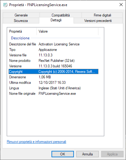

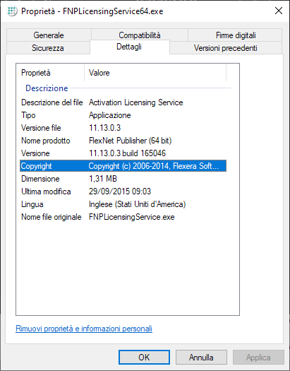

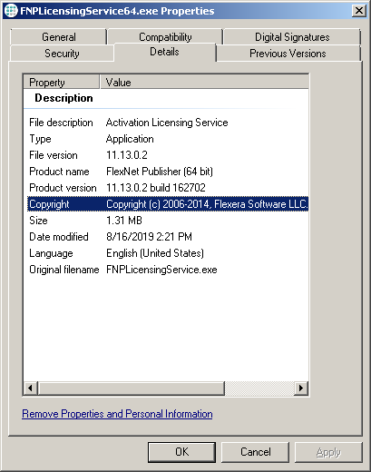

We have one more request of you. Could you please check the following?
In Windows start Explorer, right-click on Computer, choose Manage, click on “Services and Applications”, and choose Services.
Then find both “FlexNet Licensing Service” and “FlexNet Licensing Service 64” and open their “Path to executable”, something like:
"C:\Program Files (x86)\Common Files\Macrovision Shared\FlexNet Publisher\FNPLicensingService.exe"
"C:\Program Files\Common Files\Macrovision Shared\FlexNet Publisher\FNPLicensingService64.exe"
For them check the Details tab.
If either of two is not “Product version 11.13.0.2 build 16702” it would be helpful to know that – is it newer or older version, 32/64-bit or both are different.
This will help us greatly in diagnosing your issue.
Mike
17,882 Views
francesco_matti
Hello mikedoidge‌,
17,882 Views

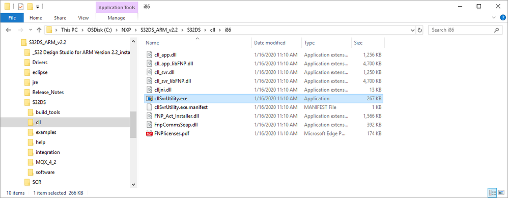

We have been able to reproduce the issue. We believe our method represents your environment closely, but it is impossible to be sure. Here are our recommendations for resolving this issue:
  1. We recommend to avoid using other tools protected with FlexNet Publisher on the same computer with S32DS.
    When a user installs that other SW, FlexNet protection services become incompatible with S32DS and S32DS licenses may be wiped from TS.
  2. In order to execute S32DS after other SW used, user should 1) repair FlexNet services to compatible version and 2) start S32DS and if needed enter an activation code.
    1. In order to repair, go to S32DS\cll\i86\ and run:
      cllSvrUtility.exe -installService DummyName
  3. Another way is to download correct (to S32DS) executables with services (attached) and replace them in the system.
We hope these recommendations will help you to resolve the issues. Please reply with your results.
Mike
17,881 Views
francesco_matti
Hello @Mike Doidge,
When a user installs that other SW, FlexNet protection services become incompatible with S32DS and S32DS licenses may be wiped from TS. -> How can i control in my computer?
    cllSvrUtility.exe -installService DummyName -> i cannot find this in my computer: can you write the exactly position?
i have downloaded the attached and i have replaced in the system...but nothing change.
17,881 Views
mikedoidge
Hello [email protected]‌,
For #2, see the image for the location of this file.
Let us know if this works.
Mike
