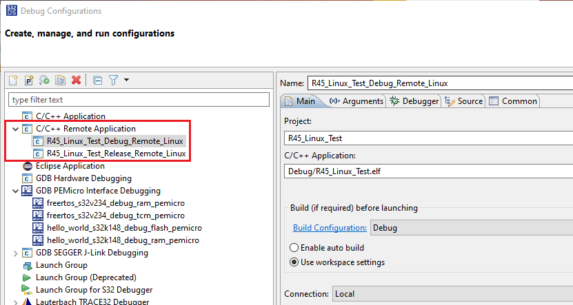

mikedoidge
Hi Praveen,
The best way to debug this application, since it is built for Linux, is by using the C/C++ Remote Application debug configuration:
I suggest you follow the steps detailed in the following article. While it is for another device, the steps are nearly the same.
HOWTO: Setup A Remote Linux Connection in S32DS fo... - NXP Community
Be sure to download the SW32R45_RSDK_Linux_SDCARD_0.9.5_D2204 from this site:
https://nxp.flexnetoperations.com/control/frse/product?child_plneID=820747
First login to your account on NXP.com, select Software Licensing and Support, then proceed until you reach the Product List page, then use the link above.
Use the image from this download and program it to an SD card and install to the EVB. Setup to boot from SD card. Just like described in the HOWTO linked above. Sorry, we don't have a HOWTO like this for S32R45.
Please try it and let me know,
Mike

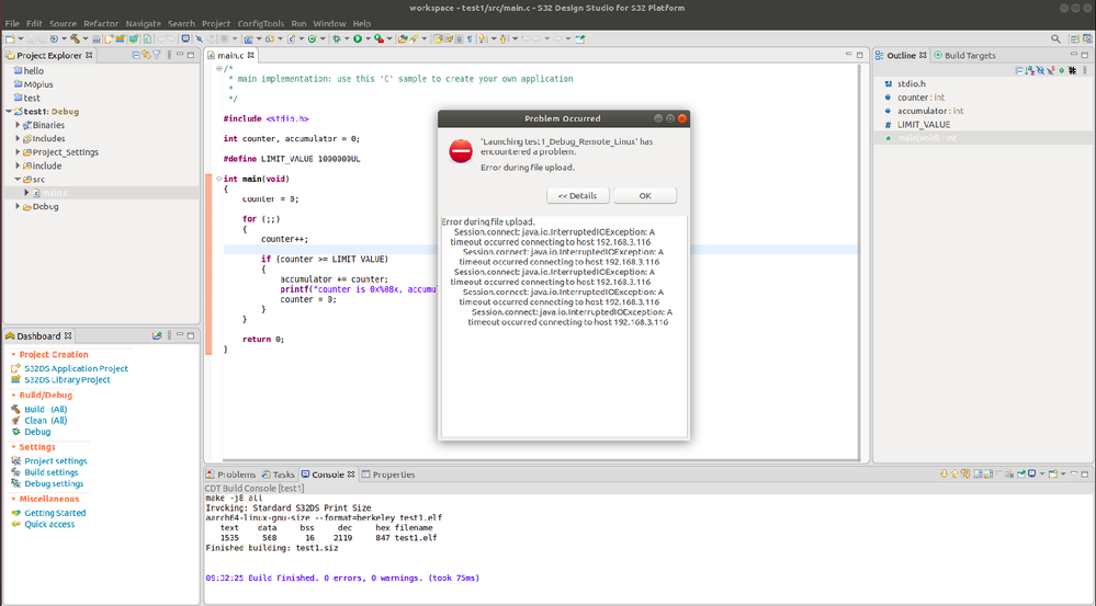

12,117 Views
PraveenKumar_K
Hi Mike, Thanks for your quick reply.
I followed the steps with Remote Linux connection for S32R45. i was able to ping the IP address of my Target from Putty Terminal but while starting debugging with the Target gives error again.
12,106 Views
mikedoidge
Hi Praveen,
From the error message, it seems it is not able to establish a connection to the target board. Probably the IP address is not correct. I know for my home network, each time I reboot the Linux on the EVB, the IP address is incremented by 1. So instead of 192.168.3.116, it would be 192.168.3.117. Please check the IP address again by using the 'ifconfig' command when connected using PuTTY over the USB connection. One additional thing, you can also setup PuTTY to connect to the board over ethernet, this way you can confirm the ethernet settings are correct.
Mike
12,050 Views
PraveenKumar_K
Hi Mike,
sorry for the delay from my side. yes as you said, each time I reboot the Linux on the EVB the IP address is incrementing. I am checking the IP address everytime &  changing in the setting in Debug settings. I also setup PuTTY to connect to the board over ethernet, still i am not able debug the issue.
let me know if i can check any other way to debug.
Thanks.
12,037 Views
mikedoidge
If you were successful in connecting to the board via ethernet with PuTTY, could you share the screen capture of the result?
If this is working, then there should not be an error from S32DS regarding connection issue with the board. They are using same communication setup. I see you have changed from Windows host to Linux host for S32 Design Studio installation. Could we focus on getting one working before we introduce potential new sources for issues? Perhaps switch back to Windows, as this is what I am more familiar with and can help you best on?
Mike

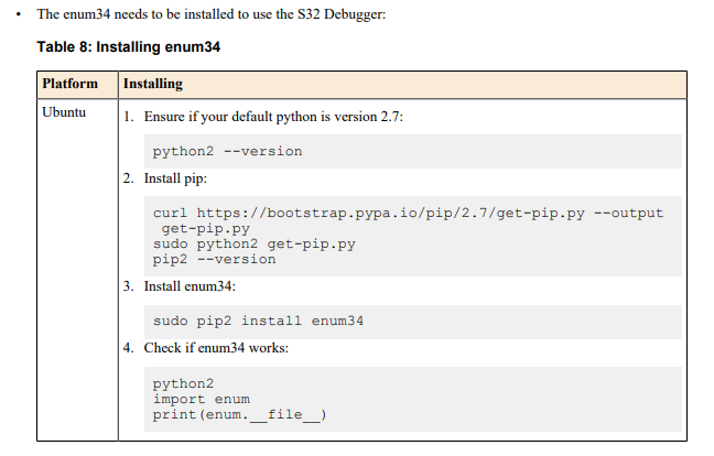

mikedoidge
Hello @prabhat_ and @PraveenKumar_K,
I finally had a chance to get back to this thread. I noticed there was an error message 'Import Error: no module named enum'. This means that the enum package is missing from the Linux Host OS where S32 Design Studio is installed.
Please see the below section from the install guide:
Mike
11,444 Views
prabhat_
yes already did that one, forgot to update. It is working fine now.
