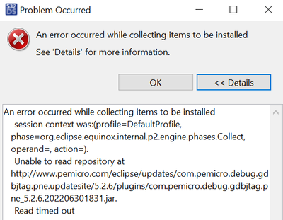

When installing SW32K3_RTD_4.4_2.0.0_DS_updatesite_D2204, several errors occurred as follow

as the picture show:
An error occurred while collecting items to be installed
session context was:(profile=DefaultProfile, phase=org.eclipse.equinox.internal.p2.engine.phases.Collect, operand=, action=).
Unable to read repository at http://www.pemicro.com/eclipse/updates/com.pemicro.debug.gdbjtag.pne.updatesite/5.2.6/plugins/com.pe....
Read timed out

Hello @DiZhang,
Can you retry after deleting S32DS.3.4\eclipse\p2\org.eclipse.equinox.p2.core\cache\ and S32DS.3.4\eclipse\p2\org.eclipse.equinox.p2.repository\cache\?

DiZhang
Thank you for your reply. I had solved this problem yet.
I think the reason is that the install sequence of update package is not right.

mikedoidge
@DiZhang,
It's possible your installation is missing a required update to the P&E drivers. Please go to Help -> Install New Software and then select 'PEMicro - http://www.pemicro.com/eclipse/updates' to check that you have the latest updates and get them installed, next check that you have the S32K3 Development Package, and then try the S32K3 RTD install again.
