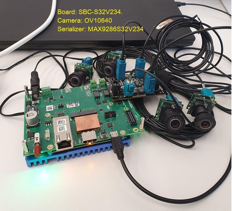

Dear Mike,
We have the following setup:
Board: SBC-S32V234.
Camera: OV10640
Serializer: MAX9286S32V234
You can also find the setup in the attached picture "SBC-S32V234_Camera_Setup.jpg" and "SBC-S32V234_MIPI_Voltage_setting.jpg"
Our team is testing with precompiled binaries "isp_ov10640_quad.elf" and observing I2C errors.

Questions:
1. What could be the cause for I2C read single failed?
2. Is there a way to check if Max Serializer is connected okay?
Thank you for the support
KK

Hi Krishnakumar,
First of all you trying to run VIU based demo with MIPI ser-des camera. You should use the VisionSDK_S32V2_RTM_1_3_0\s32v234_sdk\demos\isp\isp_ov10635_quad demo for MIPI ser-des based camera.
From the picture it seems that the deserializer board is connected to MIPI-B. To be able to run the demo, you need to connect it to MIPI-A.
Your PWA jumper settings looks OK for 12V power to deser board.
Moreover, on deserializer board set jumper JU4 to power it from SBC board.
Once you have done all these setup please make sure that orange light is lit on cameras.
If that looks good then you should try to run the app again and see the output.

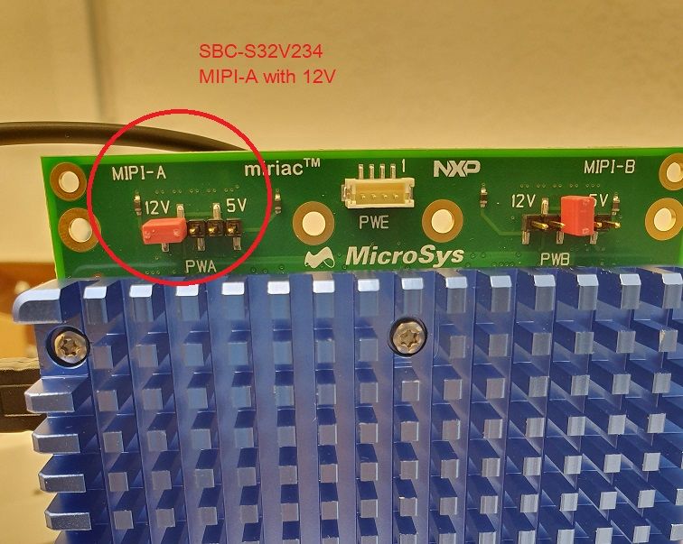

Dear Kushal,
The information provided was helpful in order to resolve the I2C errors.
As suggested,
1. we have connected to MIPI-A,
2. Place jumper JU4
3. Run ./isp_ov10635_quad.elf
The ELF file for SBC was obtained from:
Product Download, SW32V23-VSDK001-RTM-1.3.0:
+VisionSDK RTM 1.3.0 pre-built SD Card image based on Yocto rootfs.
The full log and device setup are provided below.

1. Do we need to disable the security fuses for SBC board also? if yes, could you provide the instructions or it same as EVB?
2. Please suggest the next debugging / action steps to resolve the errors
Thank you for your support,
KK

Hardware Setup:
1. On S32-SBC PWA jumper connected to 12V power to power deserializer board.
2. On S32-SBC the MAX deserializer board is connected to the MIPI-A.
3. On MAX deserializer board  jumper JU4 is set to power the camera from SBC board
(After setting the jumper the yellow light of each camera are lit).
The full hardware setup image is given below:
