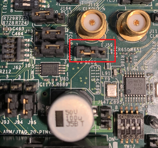

      1. Configure the JTAG. The S32G274A evaluation board supports both 10- and 20- pin JTAG connections. The default board configuration is set to 20-pin, change the position of the jumper J59 from 2-3(default)  to 1-2, if you are using the 10 Pin JTAG interface. Both are supported by the S32 Debugger and S32 Debug Probe.

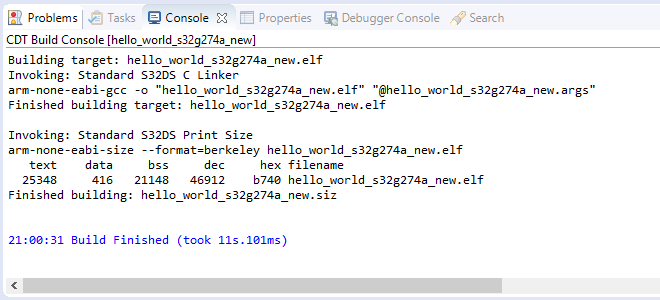

  4. Create new or open existing project and check that it successfully builds. If creating a new project, be sure the S32 Debugger is selected in the New Project Wizard.

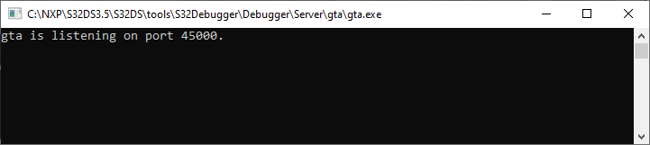

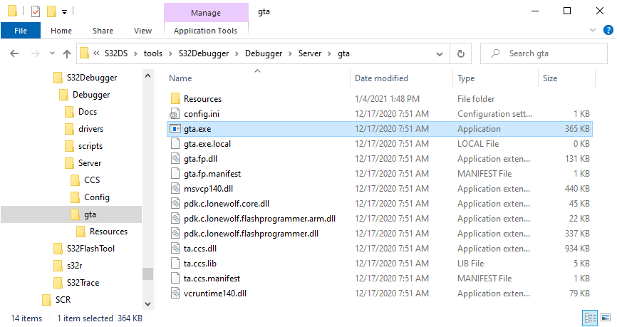

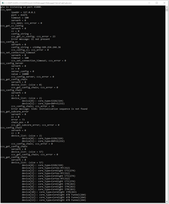

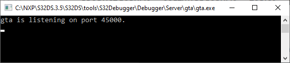

  2. Launch GTA server. From command prompt or Windows File Explorer run the command:
    {S32DS Install Path}\S32DS\tools\S32Debugger\Debugger\Server\gta\gta.exe
    Should see a window appear like this:

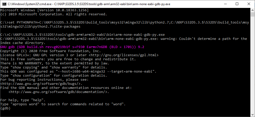

  4. Start GDB. In a command window, run the command:
    Windows OS:
    {S32DS Install Path}\S32DS\tools\gdb-arm\arm32-eabi\bin\arm-none-eabi-gdb-py.exe (for arm32)
    OR
    {S32DS Install Path}\S32DS\tools\gdb-arm\arm64-eabi\bin\aarch64-none-elf-gdb-py.exe (for arm64)
    Linux OS: arm-none-eabi-gdb-py
    A (gdb) prompt should now be displayed in the command window:

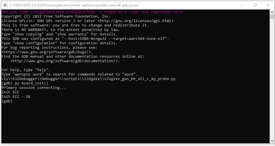

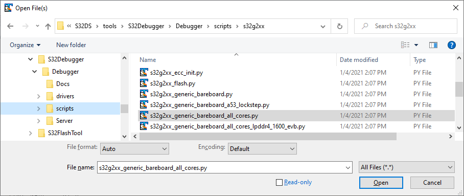

  5. From (gdb) prompt, enter the following commands(in this order):
    1. source {S32DS Install Path}\\S32DS\\tools\\S32Debugger\\Debugger\\scripts\\s32g2xx\\s32g2xx_gen_bb_all_c_my_probe.py
      This specifies the script for initialization.
    2. py board_init()
      This initializes the board. It should only be called for the initial core. In a multicore debugging workflow, the debugger launch for additional cores would omit this step.
    3. py core_init()
      This initializes the core specified in the initialization script in step 1.

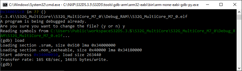

  6. Now standard GDB commands may be used. For example, you may wish to load an ELF file:
    1. file {S32DS Workspace Path}\\New_S32G_Project\\New_S32G_Project_M7_0\\Debug_RAM\\New_S32G_Project_M7_0.elf
    2. load

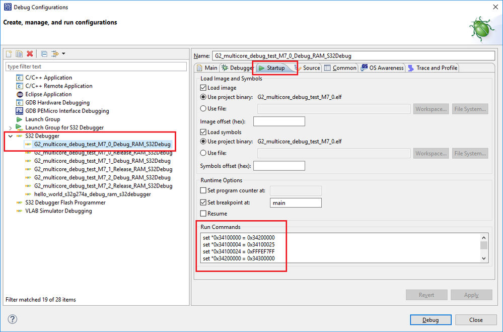

After completing the launch of debug for the primary core, it is possible to perform multicore debug by launching GDB debugging on the secondary cores.
  1. Some additional steps will need to be performed from within the primary core GDB session, enter the following commands:
    set *0x34100000 = 0x34200000
    set *0x34100004 = 0x34100025
    set *0x34100024 = 0xFFFEF7FF
    set *0x34200000 = 0x34300000
    set *0x34200004 = 0x34200025
    set *0x34200024 = 0xFFFEF7FF
    b main
    c
    These lines prepare the environment for launching debugging on secondary cores. This will allow for multicore debugging in the case of separate ELF files for each core. These can be found in the Run Commands field of the Startup tab on the Debug Configuration for the primary core within S32 Design Studio IDE, of any multicore project created from the New Application Project Wizard. Note: If there is just one ELF file for all cores, then these 'set *0x... = 0x...' commands should be skipped.
    In general, it will be correct to set the break-point at main, as shown, but this might need to be changed depending on when the secondary cores are started within the project.

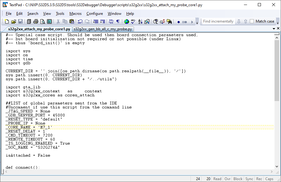

  2. Prepare the initialization script for the secondary core to be debugged.
    1. Open the core initialization Python script:
      {S32DS Install Path}\S32DS\tools\S32Debugger\Debugger\scripts\s32g2xx\s32g2xx_attach.py
      This is a different script than the one used for the primary core. It is designed to launch a debug session on a core which is already initialized and running.
    2. Edit the script for the secondary core to be debugged. Since this script is setup for the primary core, some adjustments need to be made to setup for a secondary core
      1. Uncomment the following lines:
        #_JTAG_SPEED = 14000
        #_GDB_SERVER_PORT = "127.0.0.1:45000"
        #_RESET_TYPE = "default"
        #_PROBE_IP = "s32dbg:10.222.24.64"
        #_CORE_NAME = 'M7'
        #_RESET_DELAY = 1
        #_CMD_TIMEOUT = 7200
        #_REMOTE_TIMEOUT = 60
        #_IS_LOGGING_ENABLED = True
        #_SOC_NAME = "S32G274A"
      2. Make the following changes to the lines:
        _JTAG_SPEED = 14000 ->  None
        _GDB_SERVER_PORT = "127.0.0.1:45000" -> 45000
        _PROBE_IP = "s32dbg:10.222.24.64" -> None
        _CORE_NAME = 'M7' -> 'M7_1' (this should be set to match the name of the core to be debugged, see s32g2xx_context.py for complete list)
        _RESET_DELAY = 1
        _CMD_TIMEOUT = 7200
      3. Save the file with a new name to preserve the original. For example, s32g2xx_attach_my_probe_core1.py. This ensures the S32 Debugger will still function correctly.

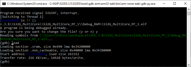

    1. file {S32DS Workspace Path}\\S32G_MultiCore\\S32G_MultiCore_M7_1\\Debug_RAM\\S32G_MultiCore_M7_1.elf
    2. load

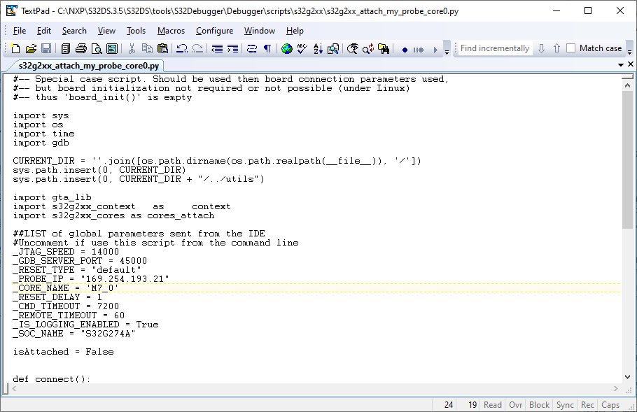

  1. Prepare the initialization script for the core to be debugged.
      • Uncomment the following lines:
        #_CORE_NAME = 'M7'
        #_RESET_DELAY = 1
      • Make the following changes to the lines:
        _JTAG_SPEED = 14000
        _PROBE_IP = "s32dbg:10.222.24.64" -> (enter the IP address of your probe)
        _CORE_NAME = 'M7' -> 'M7_0' (this should be set to match the name of the core to be debugged, see s32g2xx_context.py for complete list)
        _RESET_DELAY = 1
        _CMD_TIMEOUT = 7200
      • Save the file with a new name to preserve the original. For example, s32g2xx_attach_my_probe_core0.py. This ensures the S32 Debugger will still function correctly.

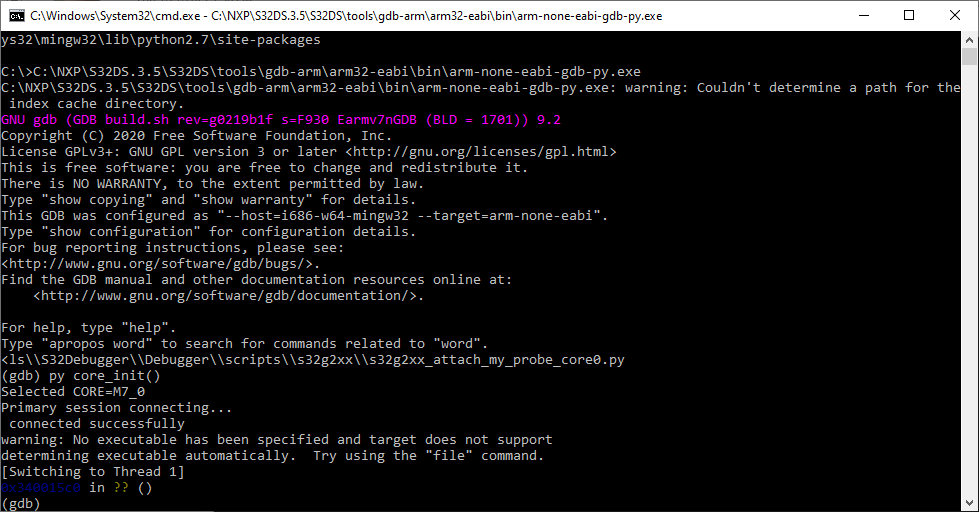

  2. Ensure Environment Variable for Python is set. From command prompt, run the command:
    set PYTHONPATH={S32DS Install Path}\S32DS\build_tools\msys32\mingw32\lib\python2.7;{S32DS Install Path}\S32DS\build_tools\msys32\mingw32\lib\python2.7\site-packages
  3. Start GDB. In a command window, run the command:
    Windows OS:
    OR
  4. From (gdb) prompt, enter the following commands(in this order):
    1. source {S32DS Install Path}\\S32DS\\tools\\S32Debugger\\Debugger\\scripts\\s32g2xx\\s32g2xx_attach_my_probe_core0.py
      This specifies the script for debugger initialization.
    2. Do not execute the py board_init() as this will initialize the board, and reset the currently executing application, which is not desired for this case.
    3. py core_init()
      This initializes the debugger connection to the core specified in the initialization script in step 1.

Hello Team,
I am trying to enable command line semi hosting for S32g2 using s32 debug probe and while following the above procedure for Primary Core Load Image and Run,
py board_init() give the below output but py core_init() is failed and gta server crashes.
Please find the attached images for output when py board_init() is exceuted.
Since the gta server window also crashes after core_init() execution, it not possible to debug or identify the reason for failure. please provide the support to identify this issue.
