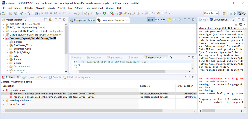

The Processor Expert "Components Inspector" view is blank for my project, see screenshot below. Also, the "Components" view refuses to display.  Could it be due to the "Peripheral is already used" error?
Below is the menu sequence used in attempting to display the "Components" view:
Why does the view not open?  How can we troubleshoot the errors without it?  I may have added components more than once, but I cannot see a way to investigate or resolve the problem. Can you help us understand how this works?
Attached is the S32DS project, in case it helps.

this example is for older SDK version which is not supported by S32DS for ARN v2.2. Try to open it with S32DS for ARM 2018.R1
Jiri
