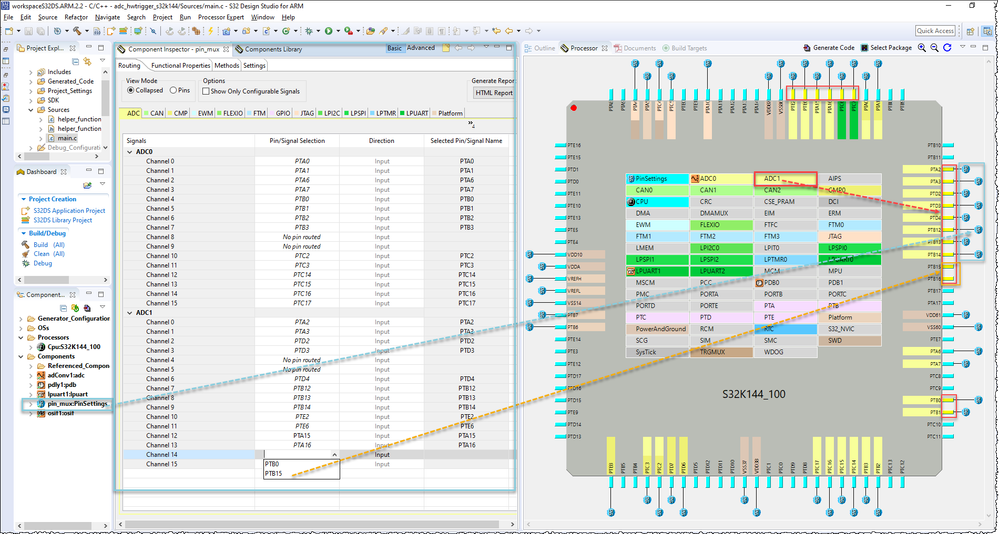

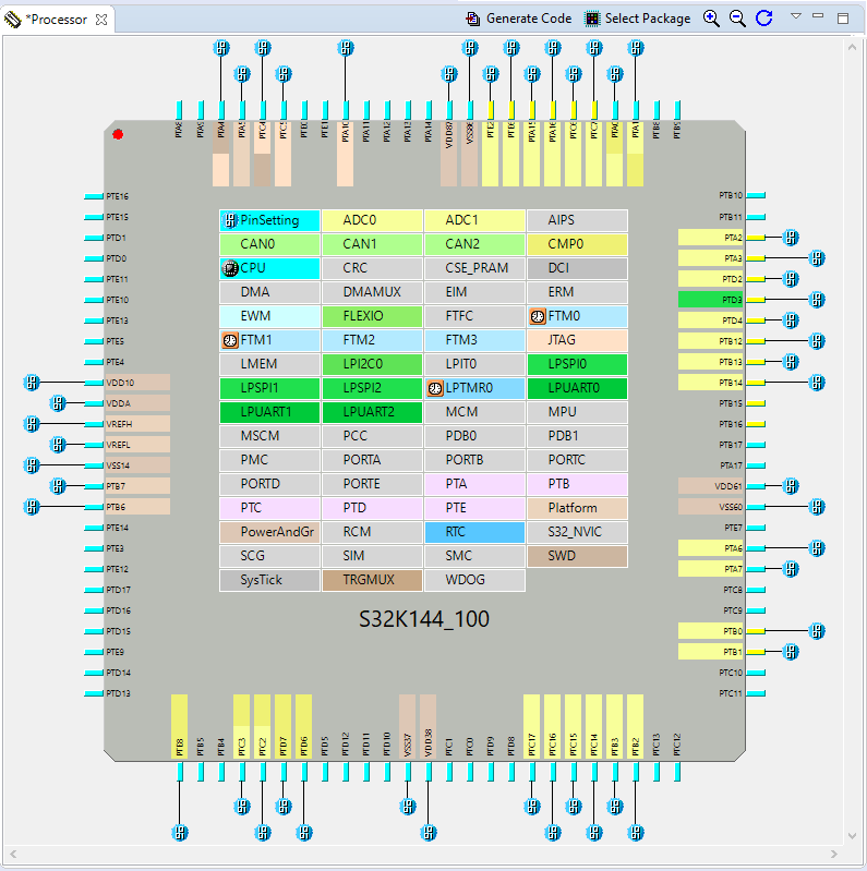

I've created a project which includes Processor Expert using the S32K144_100 processor.
The "Processor" view has gotten into a mode where a subset of pins used by ADC1 were flashing yellow.  What does it mean?  Is it a warning?  I noticed hovering the mouse over various components in the CPU changes the subsets of pins highlighted yellow to the subset used by that component, and the flashing stops, but I still wonder what it means.

Hi rsating,
It's not warning.
This is just to remind you that this module can use these bright yellow pins(pins that can be select for ADC1 channels).
The bright yellow pins without pin_mux blue icon means has not be configured this module feature(No pin routed).
