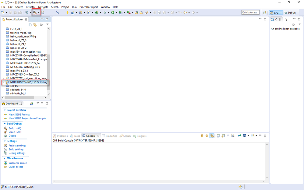

I am using S32Ds.Power.2017.R1 to program MPC5604P. I have run the default program which was in the file of MTRCKTSPS5604P named MTRCKTSPS5604P_S32DS. But i am facing great difficulty to find the declarations of microcontroller pins in the program code. I want to know where can i find the pin configurations in the code?
And I have tried generating the processor expert code, but it shows there is no active projects.

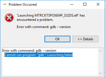

Also  when i try to run the code it shows a popup as below :

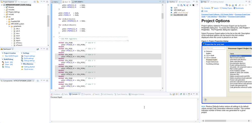

3) About pin configuration, this can be used in siu.c file.

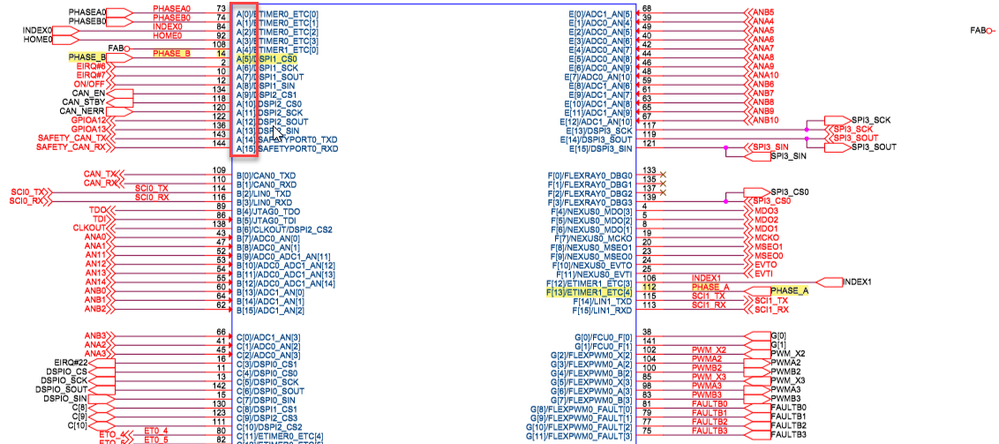

Also i have seen the siu.c file and there is pin configuration but i am still unsure, how i can relate them to the pin number from the MPC5604P MCU. Is there any documentation such as developer guide where i can find how these numbers are related?

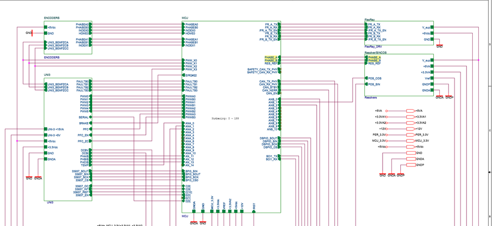

My need is to find the pins that take the information from resolver/sincos interface. But i could not find the pins that are shown in the MCU schematic in the program code. The program shows the ports instead. So i want to know how these are programmed. I have attached images for reference.

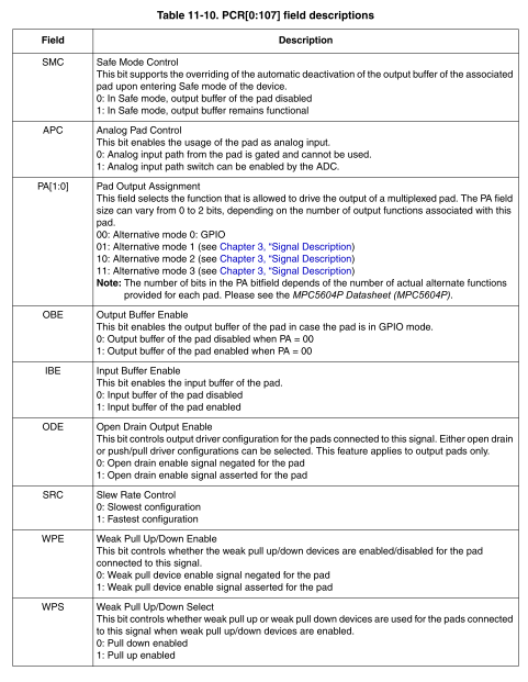

When you look into the reference manual, in chapter 3, there is pin description, which tells you, what is the functionality for
each pin (https://www.nxp.com/docs/en/reference-manual/MPC560XPRM.pdf ).
When you combine this with the figure you shared, you can see, how is every pin configured.
For example PHASEA0 is A[0] Port pin, so you can check, what is the PCR0 configuration.
Description of the PCR register can be found in chapter 11 SIUL.

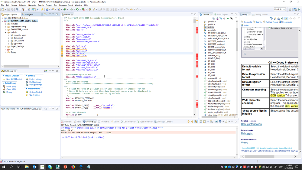

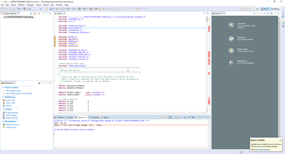

As you told in stalled the version1.2 but there was no option to open file from the system so i imported the code. And when i try to build the code i get errors such as "no rule to make target all" and "unresolved inclusions". so i tried to add the path of header files in includes but i found the header files are not available in the directory any more.  Is it because i have both versions running in my system and both versions used the code from same file.

including project into the S32DS is correct. There is no other simple way. First of all, please be sure, you have independent workspaces for both versions. Path to the workspace should not contain any special characters or spaces etc. Also, please be sure you have copied the project into the workspace for S32DS 1.2.
Could you please eventually show me the errors you receive? From my point of there, it is not necessary to modify project settings like paths, it should work by default. You can try to clean project before compiling it again.

The workspace for both versions were different. and Both versions are showing the same error now.
S32DS.Power.2017.R1
S32.DSv1.2

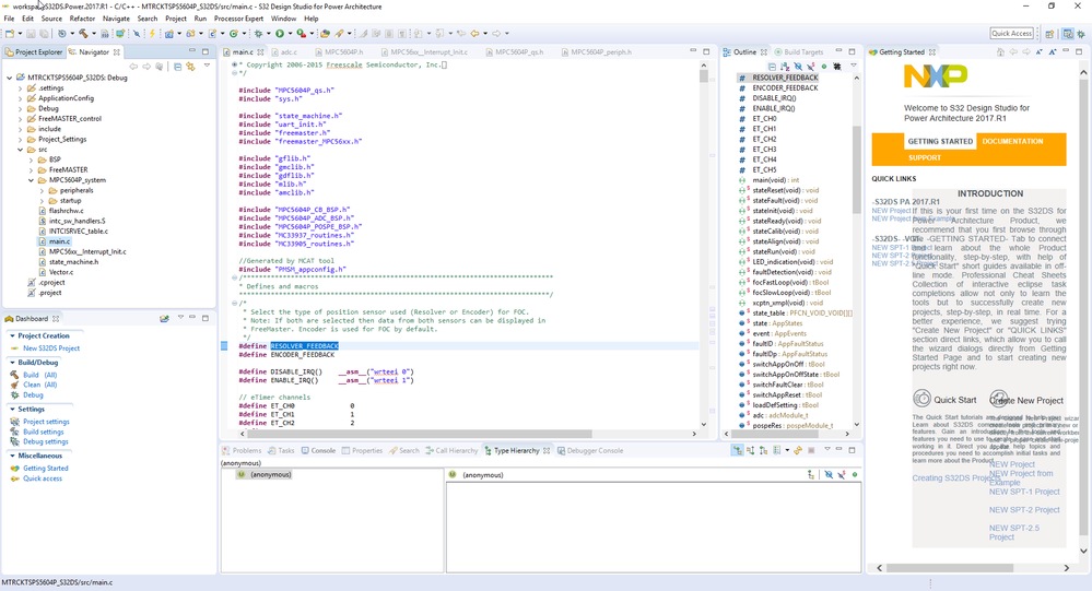

I checked on my side again and it works correct to me. I will describe the steps I did.

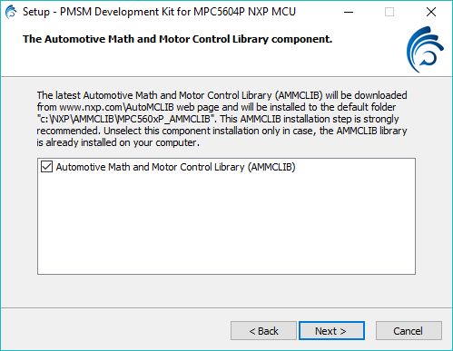

1) I downloaded application software from the link below
https://www.nxp.com/webapp/Download?colCode=MTRCKTSPS5604P_SW&appType=license
2) I installed the software including AMMCLIB
3) I installed S32DS v 1.2 and Update 3
S32 Design Studio for Power v1.2 - Update 3 available

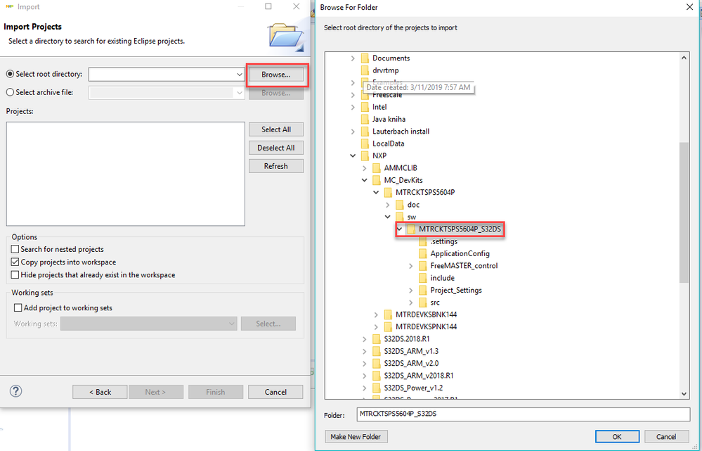

4) I opened S32DS, click File->Import->Existing project into workspace (Workspace is in path C:/Workspaces/workspaceS32DS.Power1.2)
5) I chose the installed project and clicked Finish
6) I chose the project in the workspace and clicked Build.
As you can see in the figure below, projects is compiled correct.
