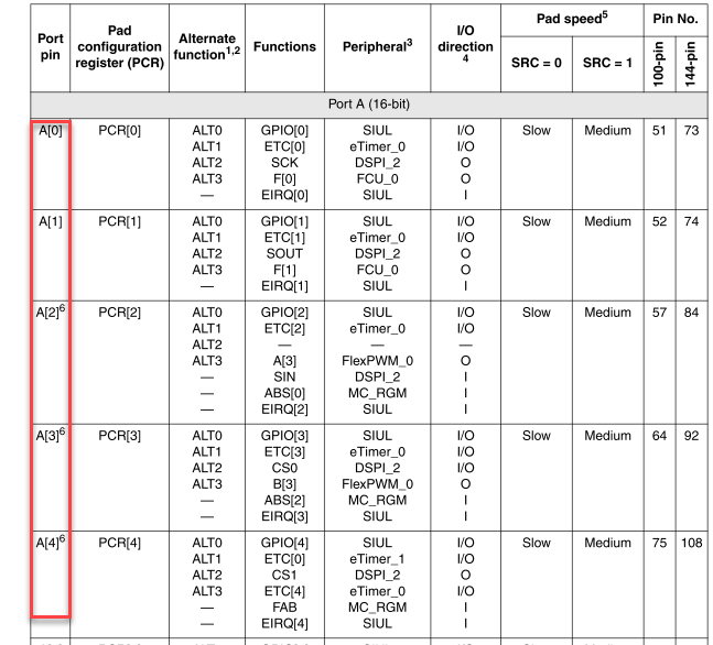

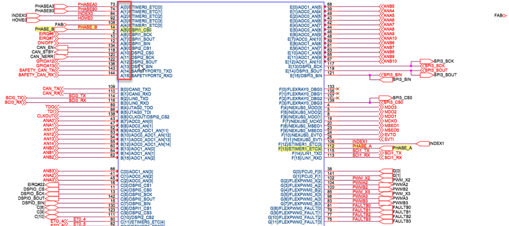

Also i have seen the siu.c file and there is pin configuration but i am still unsure, how i can relate them to the pin number from the MPC5604P MCU. Is there any documentation such as developer guide where i can find how these numbers are related?
My need is to find the pins that take the information from resolver/sincos interface. But i could not find the pins that are shown in the MCU schematic in the program code. The program shows the ports instead. So i want to know how these are programmed. I have attached images for reference.

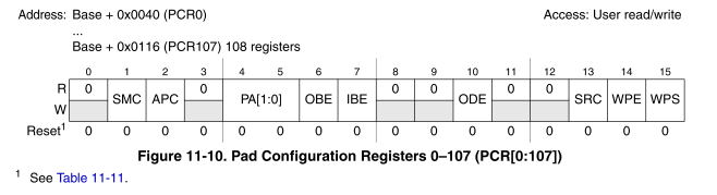

When you look into the reference manual, in chapter 3, there is pin description, which tells you, what is the functionality for
each pin (https://www.nxp.com/docs/en/reference-manual/MPC560XPRM.pdf ).
When you combine this with the figure you shared, you can see, how is every pin configured.
For example PHASEA0 is A[0] Port pin, so you can check, what is the PCR0 configuration.
Description of the PCR register can be found in chapter 11 SIUL.
