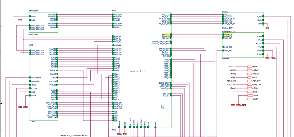

Its not equal to standard resolver solution, the outputs of the sensor are sin and cos signals. I have mainly two doubts:
1. From the documentation of µC board(MPC5604PMCBUG),it seen that the output of resolver , PHASE_A and PHASE_B goes to µC (fig). The signals from the motor position sensors are same as these signal, so is it possible to input the signal from motor position sensor to µC through these pins.
2. If the above is not possible, then i would like to know which all are the configurable pins of the µC board so that i can input my sensor signals there.

Connector J207 on MPC5604P controller board is Resolver and SinCos Sensor Interface. It is possible to use it also for SinCos sensor with appropriate settings.
I recommend MPC5604P Controller Board User’s Guide document.
https://www.nxp.com/docs/en/user-guide/MPC5604PMCBUG.pdf
Chapter 4.5 describes interface and appropriate schematics.

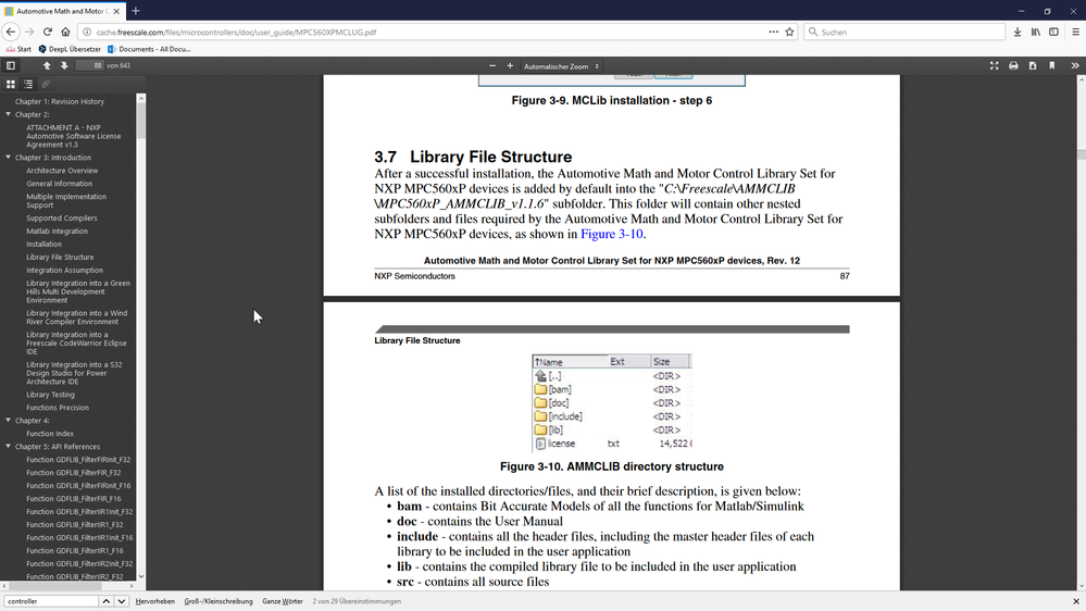

I went through MPC560XPMCLUG.pdf, but unfortunately i could not find any implementation details of AMCLIB_TrackObsrv_F32.  And could you please explain what the symbols / and * represent in the block diagram. Are they normal multiplication and division?

Chapter 3.7 in MPC560XPMCLUG.pdf describes angle tracking observer.
Chapter 3.7.1 describes observer in general and chapters  3.7.3 and 3.7.4  describes Fix 32 and Fix 16 implementation.
Equations and commentary are used for functionality and  coefficients explanations. Usage is shown in code example in the end of the chapter.

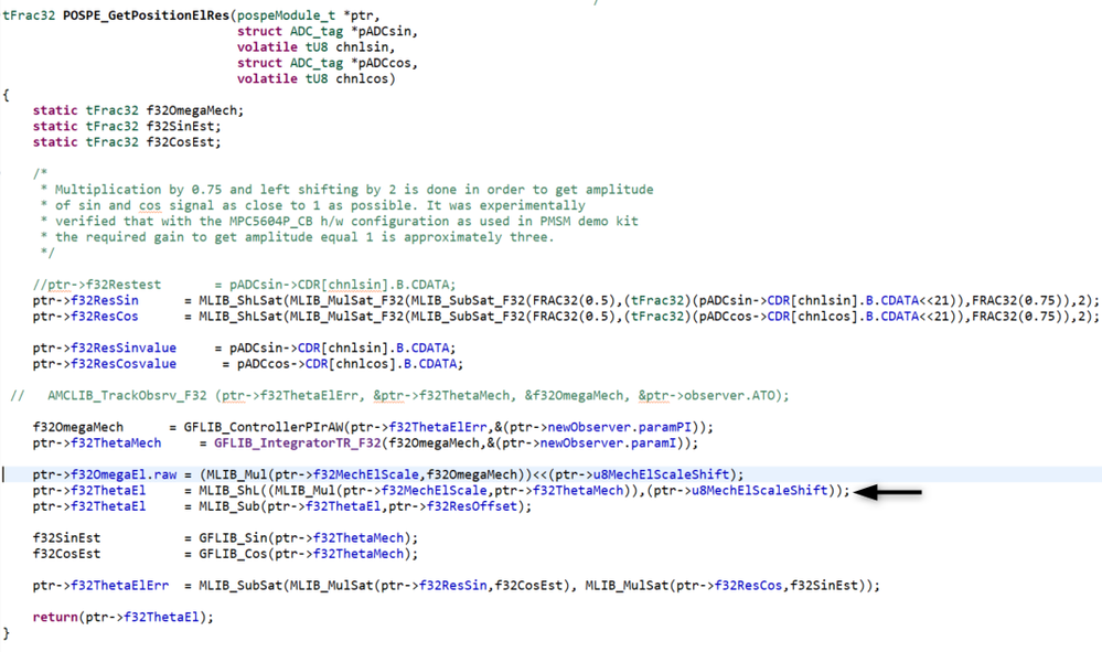

So as per my understanding, in MPC5604P_POSPE_BSP.c  the electrical position (f32ThetaEl) is obtained when mechanical position (f32ThetaMech) is multiplied with motor pole pair number (pp). But in the code, the variables f32MechElScale
(FRAC32(0.75)) and u8MechElScaleShift (2) is used. Can you please explain me how does this variables are used instead of multiplication with pole pair number.
And I see that, both f32MechElScale and u8MechElScaleShift are initialised in PMSM_appconfig.h as MOTOR_PP_GAIN and MOTOR_PP_SHIFT.  And I see that similar variables are there for resolver too (RES_PP_GAIN, RES_PP_SC), so I thought I could use these variables for ATO modification instead of multiplying directly with Resolver pole pair number. But I really not sure how does it work.  So can you pleas explain me about this.

yes electrical position (f32ThetaEl) is obtained when mechanical position (f32ThetaMech) is multiplied with motor pole pair number (pp). But this multiplication is done in fraction arithmetic. In this case motor pole pair number is 3. Fixed point 32 bit fractional numbers are in range  <-1,1). You can find in MPC560XPMCLUG.pdf chapter 2.2. Motor pole pair number is split into f32MechElScale =FRAC32(0.75)) and u8MechElScaleShift =2.
0.75*(2^2) = 3
x*2^2=LeftShift(x,2)
so multiplication is done in 2 steps.
Step1: Multiplication of Fraction numbers f32MechElScale and f32ThetaMech. Booth numbers are in range <-1,1) as well as result.
Step2: Left shift.
ptr->f32ThetaEl = MLIB_ShL((MLIB_Mul(ptr->f32MechElScale,ptr->f32ThetaMech)),(ptr->u8MechElScaleShift));
Moreover wrapping is ensured by this approach.

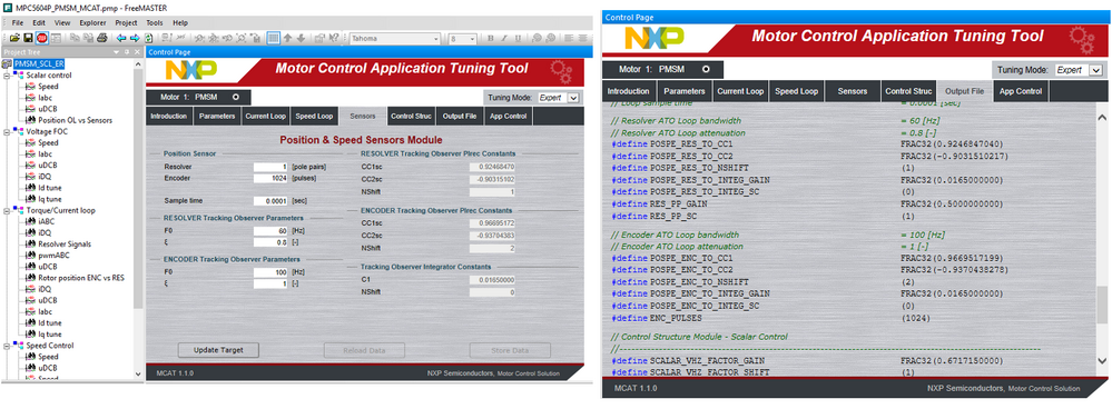

Thank you Tomas, I derived this by trial and error in the meantime and i was able to get output for both speed and angle signal from our newly added sensor. But only when i select resolver in Freemaster. So i created a new variable in JavaScript for the new sensor and was added to each page . I then found a variable "PositionType" which is used in many .js functions in the "if" condition to select sensor. I couldn't find what it stands for. I tried using "Typeof" operator and it shows the type as "undefined". Could you please check on this and let me know what variable is that and how is it possible to add new sensor to it.
10,544 Views
tomasfedor
Hi Aparna,

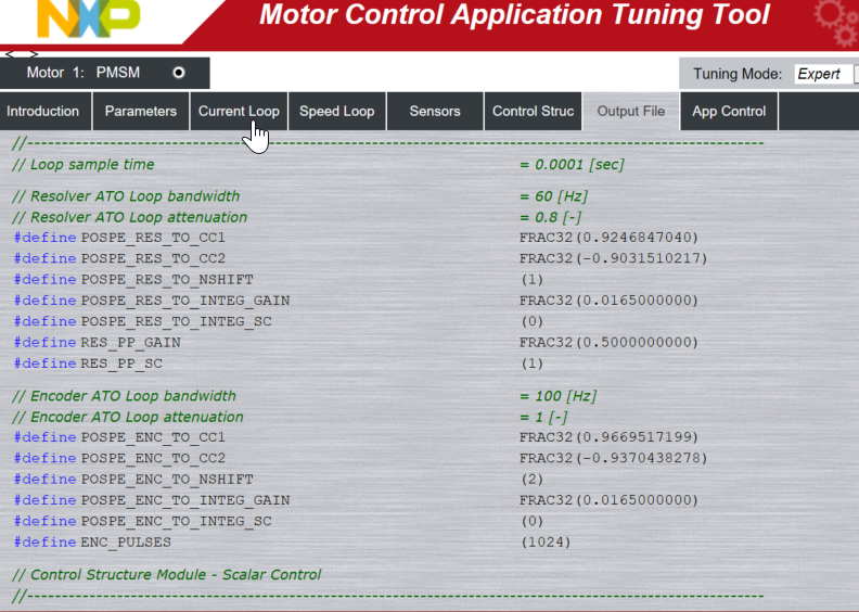

Lines 73 and 84 test whether encoder and resolver are selected. You can open application setting by pressing settings button.
But what is the motivation of editing pages and JavaScript files?
You can use sensors tab for constants calculation and you can use these constants (stored in output file) in your application.
Tomas Fedor.
10,544 Views
fixed-term_apar

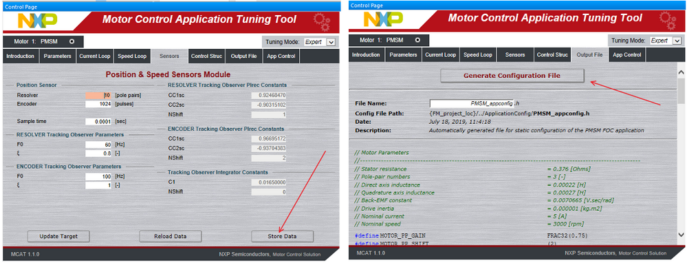

Thanks for the reply Tomas. The reason why i thought of changing js files is that even after adding new sensor in S32 design studio- PMSM_appconfig.h the values for newly added sensor was not seen in freemaster. Is this has to do something with the js files? I thought i might have to make changes there as well and i found it has only 2 sensors everywhere and i may have to make changes to add the new sensor.
10,544 Views
tomasfedor
Hi Aparna,
if you press store data button constants will be stored to "output file" tab and when you press "Generate configuration file" button constants from "output file" tab will be stored to PMSM_appconfing.h file and you can use them in your Design Studio project.
Tomas Fedor.
10,544 Views
fixed-term_apar
Hi Tomas, Yes, i understand what you are saying, this could be done if we have just 2 sensors. I have added a third sensor externally and want to compare it with output of resolver. So the details of third sensor is not present in Freemaster. So does it automatically get updated in Freemaster or should i make changes in js, html or xml files.
10,544 Views
tomasfedor
Hi Aparna,
yes MCAT doesn't offer possibility of having 2 resolvers for one motor. But you could use a workaround.
It is possible to add second motor by selecting "dual motor" in Application setting page->general->number of motors and add resolver to second motor.
There will be 2 motors in MCAT and it will generate (by pressing "Generate Configuration File" in "output file" tab for every motor) M1_PMSM_appconfig.h and M2_PMSM_appconfig.h instead of one PMSM_appconfig.h .
You can use generated constants for new sensor from M2_PMSM_appconfig.h.

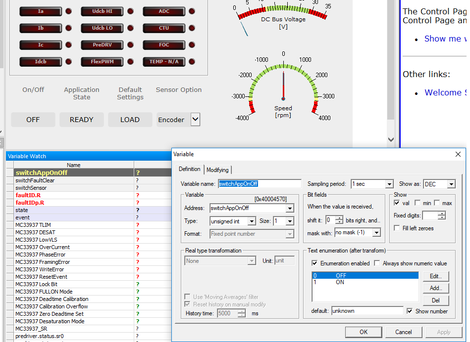

Waveform visualization is task of Freemaster (Mcat is for constants calculation and tunning).
You can use scope or recorder for waveform visualization. Any global variable from the Design Studio project can be added as freemaster variable and you can see its value in Variable Watch, recorder or scope. You can find more details in freemaster user guide. Pdf document is installed with your Freemaster.
MCAT can update some variables during run time by pressing "Update Target" button. It is good feature for online tuning.
Relation between MCAT and Freemaster variables is given by  FM_params_list.xml and generated constants naming is given by Header_file_constant_list.xml.
Example of on/off button in app control tab:
You can find line in FM_params_list.xml:
<M1_onoff>switchAppOnOff</M1_onoff><!-- Main application switch of MOTOR1 -->
what means MCAT onoff for motor 1 controls Freemaster variable switchAppOnOff.
Freemaster variable switchAppOnOf covers embedded variable switchAppOnOf (address 0x40004570).
