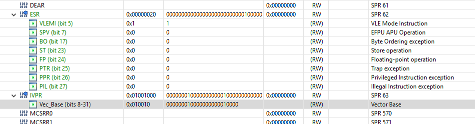

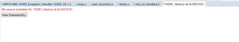

huqiang
Hi, Martin
      I have run you IVOR2_Exception project on my MPC5748G EVB. But it seems it will cause a IVOR1 error.
      When I suspend the project, it will became as the figure shows. I try to add a breakpoint in the function of IVOR2_Exception_Handler, but it seems that the project didn't run into the IVOR2_Exception_Handler .
Is there something that I misunderstanding?
Qiang

martin_kovar
I found the issue. If you step the code, IVOR2 occurs, but if you run the code, IVOR1 occurs. I am not sure, why this behavior becomes, but it could be possibly cause by some synchronization. Please give me a time, I will update the example.
Martin
