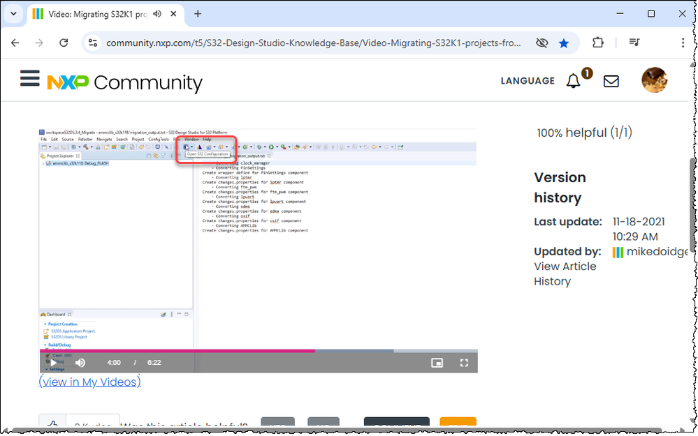

I have a project for S32K148 that was created with S32SD for ARM v 2.2. The project compiles and runs as expected. It uses SDK 'S32SDK_S32K1xx_RTM_3.0.0'
In my attempt to upgrade to S32DS v 3.4 (the eventual goal is to upgrade to the latest v 3.6.2, but I used 3.4 as a interim stepping stone so that I can use the automatic migration feature of the SDK), I did the following:
1. Installed SDK 'S32_SDK_S32K1xx_RTM_4.0.2'
2. Installed S32DS v 3.4
3. Opened the project with S32DS v 3.4
4. Right clicked on the project and clicked 'Migrate'
The migration tool correctly identified SDK_S32K1xx_RTM_4.0.2 as the available migration and I chose all the default options. This created (among other things) a new directory called 'board' and created some new .c files (such as 'peripherals_SPI0.c') that has no actual source code except an include file with the same name (e.g. peripherals_SPI0.h). The problem is that these header files don't seem to exist, either in the project or in the SDK.
What am I missing?

Did you click Open S32 Configuration and then click Update Code?
Open S32 Configuration Migrating S32K1 projects.pngOpen S32 Configuration Migrating S32K1 projects.png

Thanks for the hint and this fixed the issue. FWIW, the triangular exclamation in my case was green and the 'update code' button seemed to be greyed out, but clicking on it anyway solved the issue.
