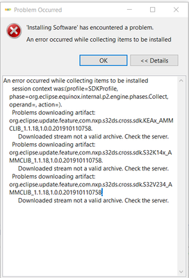

'Installing software' has encountered a problem while trying to install all available software in S32 Design Studio (S32_ARM_2018.R1).
 Encountered problem.

I tried to install all other vaailable updates except "AMMClib", as you mentioned. But another problem encountered and I attached below.

I just tested fresh S32DS for ARM v2018.R1 and full update and there is no issue. Please check your network/firewall settings and User privileges on your machine.
It is also possible that your S32DS installation is somehow corrupted, re-installation may fix the issue.

try to uncheck all ammclibs, install other updates and when done, try to install ammclib. I'm not sure if you need all versions for all parts. You can choose only AMMClib for your target device.
