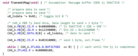

Hello NXP Community,
I am trying to implement CAN communication on MPC5775E. My Transmite and Receive functions are as follows. While debugging, I see that it is stuck in the while loop inside the TransmitMsg function.
while ( CAN_A.IFLAG1.B.BUF31TO8I == 0) { } // wait until the tx is completed.
Could you pelase help me how to solve these problems?

PetrS
this while statement is checking if MB flag is set, that is, if message is successfully transmitted without error.
So check that, if any error is detected (ESR1, ECR registers), check MB CODE field.
Do you have node (MPC5775E with active CAN transceiver) connected to any other node and bus properly terminated?

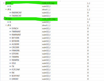

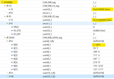

bk13
Hello Petr,
Thank you so much for your help and interest. ESR1 and ECR registers are zero.
MB Registers are as below. It seems to be true
Best Regards
