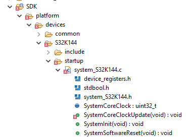

I am trying to compile a project with SDK. I get a bunch of "not resolved symbols" and undeclared variables.
I read in another thread that it migh be due the "include" folder is grayed out. The thing is that I checked in my project folder and that "include" folder does not exist. How can I create it?

Sure, I'll attach the screenshots. In fact I'll attach 3: 1 showing the missing path, 1 showing the folders created when it is first imported from the model, and 1 showing the folders created after the SDK is added.
There are SDK folders created, yes.
But I don't think that's the problem anymore. What I think is, since I am importing the model from Simulink, it imports a bunch of .h and .c files that then, when the SDK is added, are added again with different parameters and in different locations but with the same names. There are a lot of variables that are "undefined" because the tool doesn't find the right document to look into, and manually change it would be super messy.
So, for example for the "system_s32k144.c" file, it is imported at the beggining from the simulink model into the Design Studio. But then, when the sdk is added, another "system_s32k144.c" file is created but in SDK>platform>devices>S32k144>startup.
In conclusion, I think the problem is that the creation of these additional files is creating conflict and that's why for all the undeclared and unresolved variables. I don't know how to solve that. Manually would be messy and doing manual changes for every project is not an option. The final objective was to implement RTOS but without the SDK working I don't see how this could be done.

Hi Juliana,
try to copy your include folder from your .zip into project folder. If there are duplicated SDK files, you can exclude it from build:

It mostly worked! I don't have any more errors in the SDK folder. I have errors of "undefined variables" from files that used to work before the SDK were added. (I attached a screenshot).
I found here a solution, that didn't quite worked.
I also noticed here that you sugested something related to the AMMCLIB, which I don't think I have in my includes.
But I have the file .a added at the root.
Is that enough? Should it be among my includes?

I am using the S32DS.ARM.2018.R1 version. I don't think I used expert generator since I don't know what that is. I only imported a .xml from a project created in Simulink.
When I first build it, it goes well. There's only these warnings:
When I attach the SDK, and then press build again, it's when all the errors appear.
Kind regards, Juliana.
