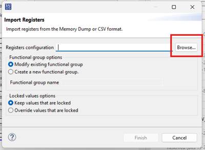

Press the import button:
Press the "Browse..." button and search for your file

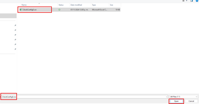

Select the file you have exported previously:

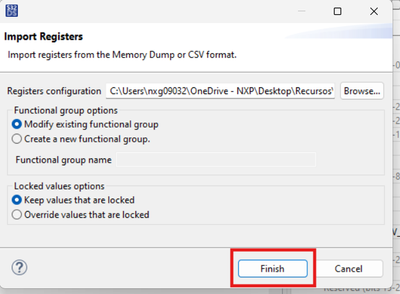

Once selected click finish:

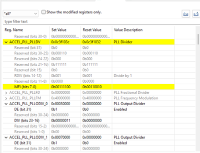

You will see the modified values highlighted in yellow:
