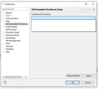

We followed same procedure as per HOWTO: Install IAR Eclipse plug-in into S32 Design... - NXP Community  and we are facing IAR plugin issue for S32 Design Studio. Getting below error.
When I checked window->Preferences
then not getting IAR Embedded Workbench but it is already installed and all updated are also installed.
We are working on urgent project and we need to resolve this issue as soon as possible.
Thank you in advance.

what's you S32DS Version?

Hello @jiri_kral ,
We are using S32K Design Studio 2018.

this old S32DS supports IAR compiler v7.x and v8.11.2 . If you later IAR version, please use S32DS for ARM v2.2 - https://community.nxp.com/t5/S32-Design-Studio-Knowledge-Base/S32-Design-Studio-for-ARM-2-2-Windows-...
Hope it helps.
