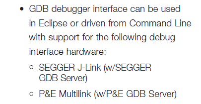

I have same problem, I want to create MK20DX128 openSDA(empty chip) for S32.
1. pemicro only
2. Where can I find the openSDA bootloader bin file?
4,707 次查看
stanish
Theoretically you could replace OpenSDA with OpenSDAv2.x and use e.g. segger Jlink instead of Pemicro.
The automotive development boards with OpenSDA (such as DevKit S32K144) interface are not currently open to change the bootloader firmware.
K20 (OpenSDA) chip is secured so it's not possible unsecure/erase/reprogram it.
Hope it helps.
Stan

ZhangJennie
hi,
there are some points you need to consider:
1. s32ds includes supporting for some kinetis chips but it supports KEA only.  s32ds doesn't support MK20DX128.
all the supported devices are listed on our website:
S32 Design Studio IDE|NXP
2.  do you use NXP demo board? which board do you work with? if TWR-K20D50M, CMSIS-DAP doesn't support it.
3.  according to S32DS Fact sheets, it only support J-link and P&E interfaces. there is no official solution for CMSIS-DAP interface.
4. if you work with MK20DX128, I suggest you use KDS.
Kinetis Design Studio Integrated Development Envir|NXP
Hope this helps!
Jennie Zhang
