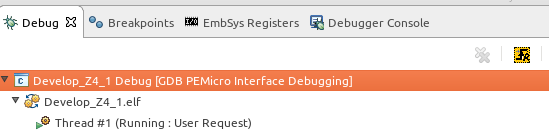

I can download a program using the bug button in the main toolbar

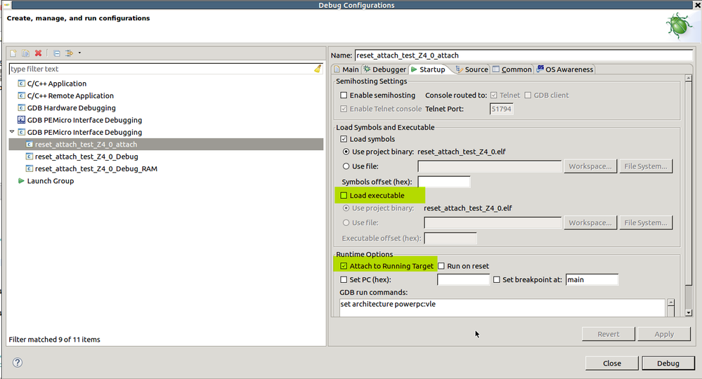

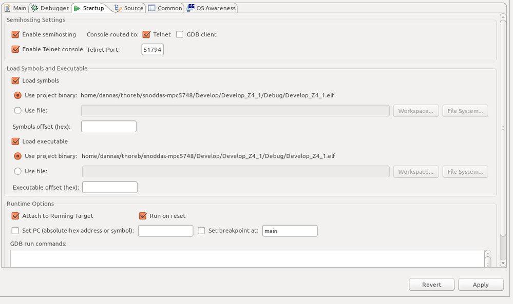

There's a "Attach to Running Target" checkbox field in the Debug Configurations dialog
There's a yellow HW reset button in the Debug View
But the HW reset takes ~30s for me to take effect with a small program. And sometimes it fails completely. Is that expected?
When I want to attach to a program I've filled in the checkbox and started debugging. Sometimes I've succeed in attaching, and sometimes not. And when I've had the Attach to Running Target checkbox filled in by mistake I've started a debug session in the belief that the new version of the software was flashed to the device, when in fact, the debugger just attached to the old running software.
Is there some option that I've missed? Any suggestions on how to configure S32DS to make it clearer if the debugger will just attach or if it will download the program?

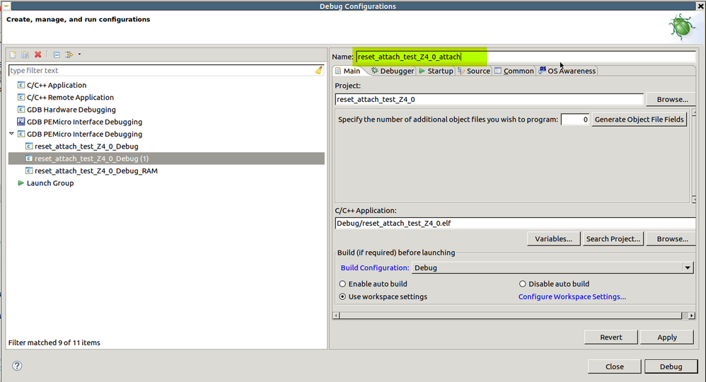

jiri_kral
did you update your installatiion of  S32DS?
For me with PE Micro Multilink FX takes reset about 3 sec (because of RAM Init).
To make attach easier - you can create your own debug settings with attach only. Duplicate existing debug configuration, rename it and configure for attaching:
Hope it helps.
Jiri
