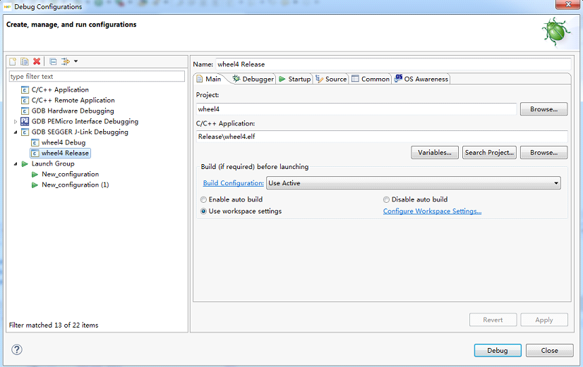

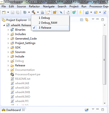

When i use s32ds(version is 2018.R1) create a project,I want to build the project using release,1.png
It can build successful

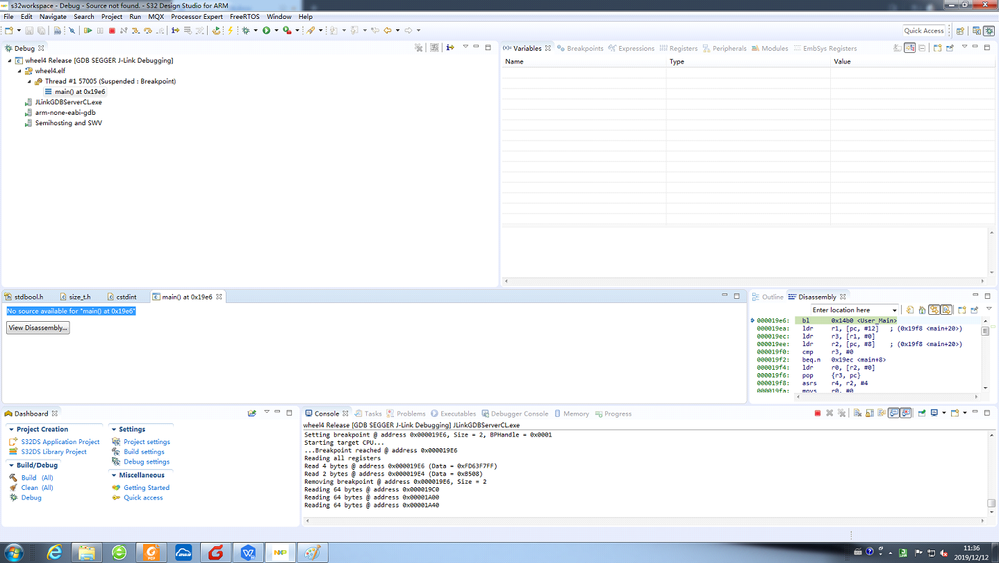

But when i download the file to the mcu(s32k144) with release,it can’t run .see the picture
How could i use release with s32ds?

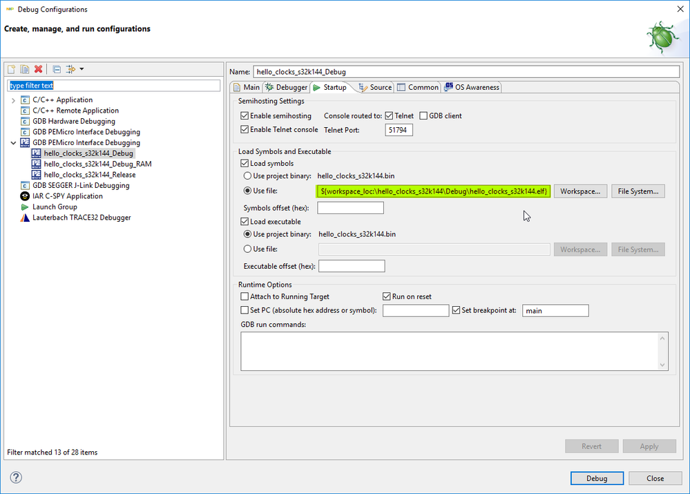

release version of .elf file doesn't contain symbols and debug info. You can normally run it, but for debugging you can see only disassembly.
If you need debug release version - you can load symbols from Debug .elf:

yongwan
only load symbols select debug. elf   is not ok
load executable use debug. elf  is ok
the thing I want to know is the debugging file is debug. elf  or release. elf

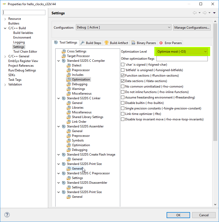

forgot mention that you  need to use same optimization level for both confugurations. By default Debug has -O0  and Release -O3
Anyway, the only difference between Release and Debug .elf is the -g option. The binary code is same. So, you can normally use for "Release" debugging Debug output with optimization level of your choice. Technically there is no Reason for debugging Release version.

debug is ok
