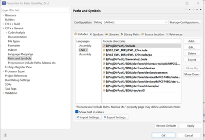

I am using MPC5748G development kit with S32DS., new project is created by selecting create from example the generated files are referring header files from installing folder instead of project folder.
Any changes made to project folder are not being reflected to project instead header files in installing location are being reflected to project.
As a work around header included as following:
Please let me know if there is permanent solution.

Thanks for response. I did little search and found it.
.PE file already contained generate mode as "standalone".
I just removed include paths which were pointing to "c-drive" in "properties/Paths and Symbols/Includes".
After update:

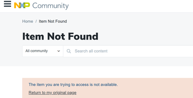

I found the updated link:
https://community.nxp.com/t5/S32-Design-Studio-Knowledge-Base/HOWTO-Use-SDK-based-example-code-as-st...
Actually, it seems, the link was correct, only the 4 at the end was not interpreted as part of it.

Thanks for response, page is no longer available.
Can you please check & reshare?
