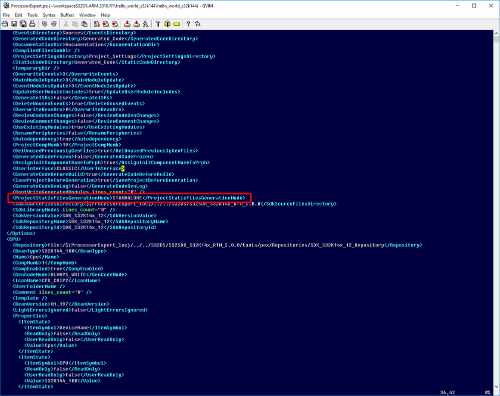

By defalut is SDK code in examples linked into project. Unfortunately there is no GUI config option, but this settings can be changed in ProcessorExpert.pe file - located in project's root folder.

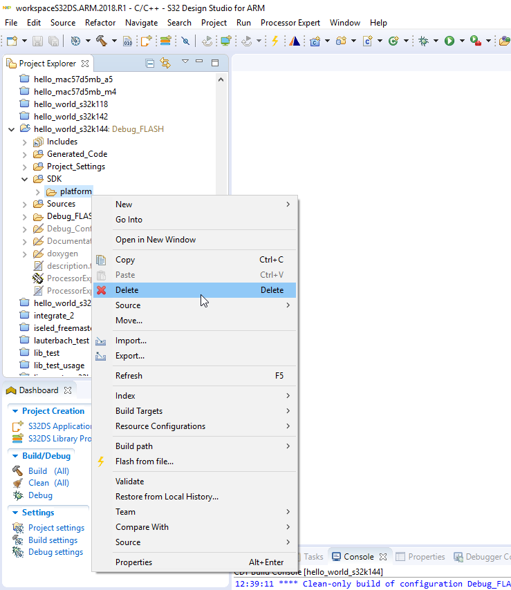

First of all - backup your project. Locate SDK folder in project and delete all content. When done - close your project.
Open ProcessorExpert.pe file located in project's root folder in any text editor (it is XML file), locate <ProjectStaticFilesGenerationMode> tag and change value from LINKED to STANDALONE:

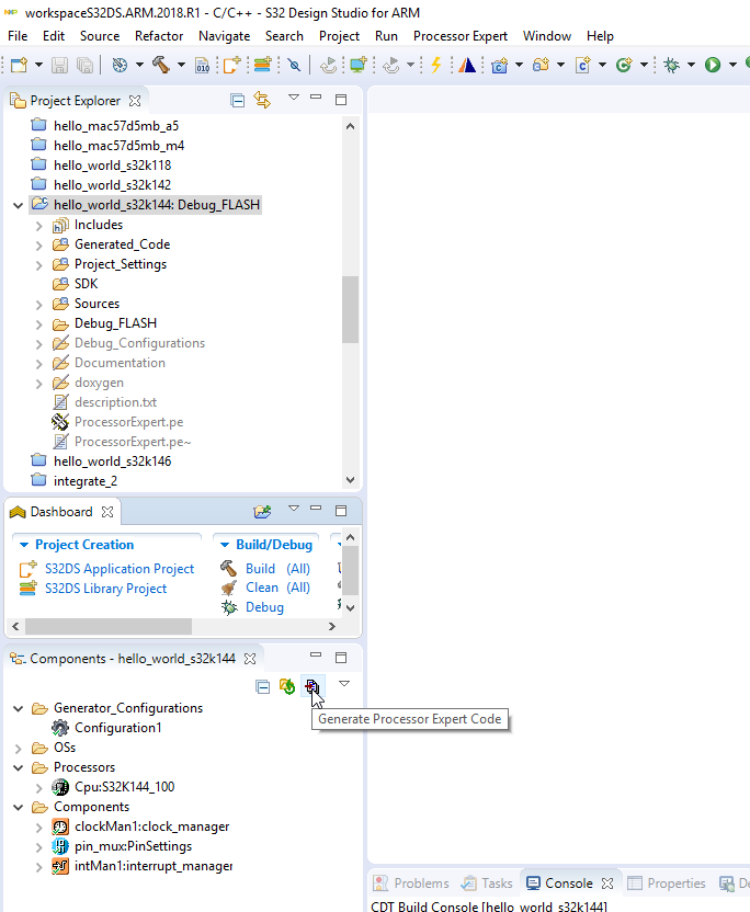

Save changes and open again your project in S32DS. Generate processor expert code:

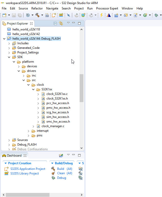

Now - all SDK code is copied into workspace:

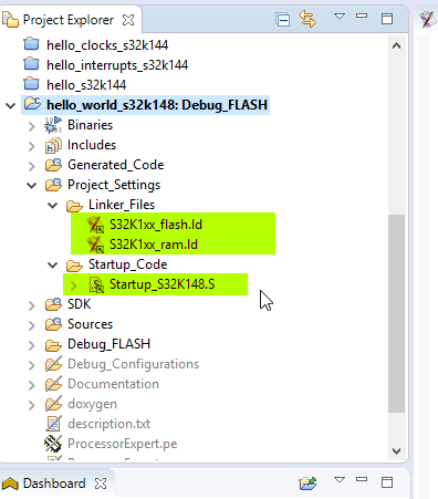

There are also linked files in Project_Settings. Easiest way is just create an empty non SDK project and copy linker script and startup assembly to your project:

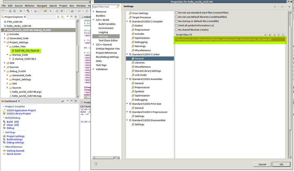

Make sure, that Linker uses your copied linker script file:

Hi, Kiri
I met the same problem and now solved by your method, but maybe a typo that, as you mentioned "locate <ProjectStaticFilesGenerationModule> tag", it should be "locate <ProjectStaticFilesGenerationMode> tag".
Thanks for sharing.
