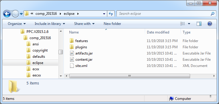

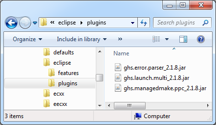

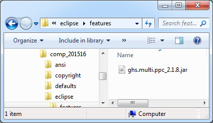

lakshmikanth
Hi Stanislav,
a) I have the following contents in GHS (2015) -> eclipse folder. So first thing i'm not sure which jar file is to be selected from below. i.e artifacts.jar or content.jar
b) Secondly: In folders "eclipse->features" and "eclipse->features" also there are some jar files.
- Please let me know if you have any idea on whether these files are correct or not.
So, are any of ".jar" file can be selected for integration GHS Plugin to S32DS. I'm clueless.
Thanks for your support.

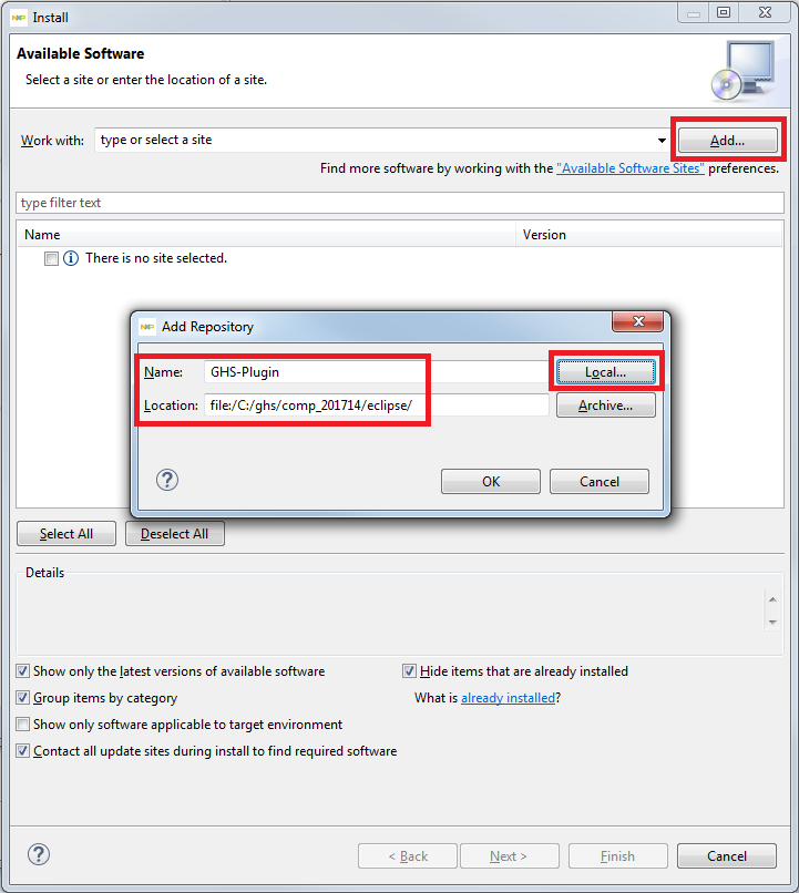

mikedoidge
Hello lakshmikanth‌,
The process to integrate the GHS Plugin is much simpler than you are making it to be.
Just go to menu "Help" -> "Install New Software" and click on "Add..." button. Then select 'Local...' and navigate to the location stanish‌ identified. You do not need to select any file, just navigating to the folder is enough. After you click on 'OK' from the Add Repository menu, then you should see the list of GHS Plugins. Select the one for PowerPC as this is the correct one for MPC5777C. Click 'Next' and follow the prompts until it is installed and the S32DS is restarted.
